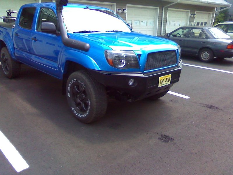

    do you have any pictures of your truck

    Yes. These is a pic with the Icons. For some reason i can't find the rest. I will take pics with the 884 s tomorrow. These pic does not show the tires and how it looks from the side.
