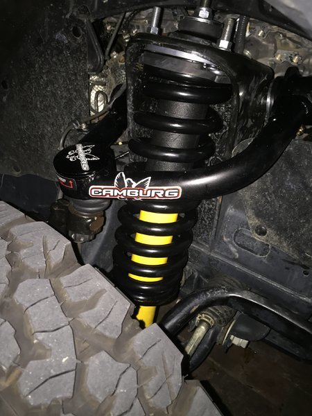

    I'm running 275/75r17 with -12mm offset with OME coils and come far from rubbing (about 1.5" at full lock) I have the 13mm coil spacer and extended studs from wheelers offroad. Maybe try the 13mm spacer instead of cutting more. This is what it looks like.

    Ok Thanks I think I will try this
