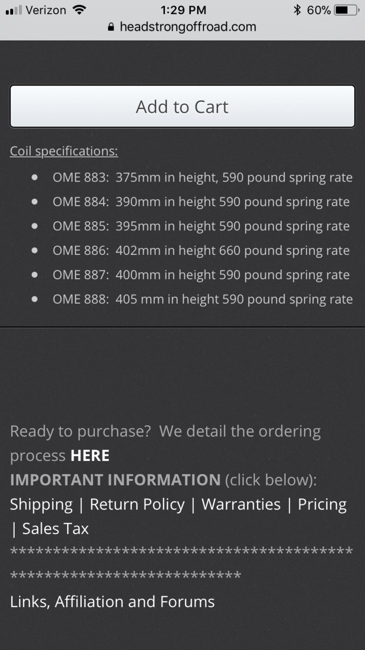

    Are the 888's T4R coils just like the 887's?
  19. Jan 18, 2018 at 1:30 PM
    #39
    Friedtacolover
    Friedtacolover Well-Known Member
    Sep 2, 2014
    #137481
    1,560
    Travis
    Ontario, Ca
    2017 DCSB Off Road 4x4
    my build tread: https://www.tacomaworld.com/threads/socal-no-shame-poser-build.513084/
  20. Jan 18, 2018 at 1:32 PM
    #40
    geekhouse23
    geekhouse23 The "Liftman" - @DrFunker
    Jul 14, 2013
    #108251
    15,713
    2GMGMDCSB4WDTRDFTMFW!! TL;DR
    mostly stock, grocery gettin' Prius
    I see the rates, just trying to understand the application
