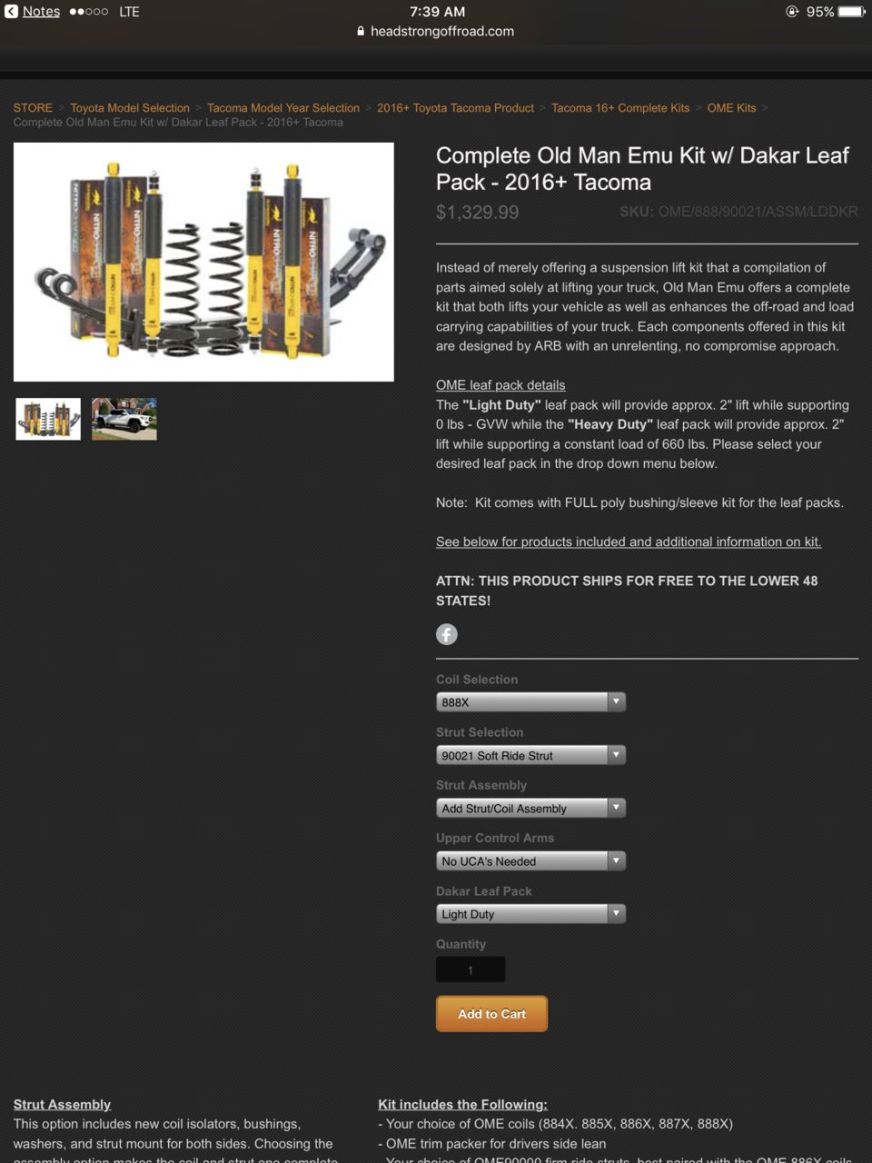

    Is there a height difference with Dakars heavy duty vs light duty?
    Based on all your suggestions, I'll be going with:
    887 or 888 springs
    90000 firm strut
    Light Racing UCAs
    Heavy duty dakars?
    This setup should provide a leveled 3" lift and will fulfill my offroad handling?
    Since I'm on the "firm" side, I want to know how the drive is on pavement. Details?

    Id change strut from firm to sport. Id only do firm with 886 springs. Just remember heavy dakars are for constant load of 500lbs so like a rack rrt and full bed all the time
    I have firm struts and springs now with no added weight (installing bumper sat) and its just fine. I am getting a jolt on speed bumps in prking lots but thats it. I cant figure out why.

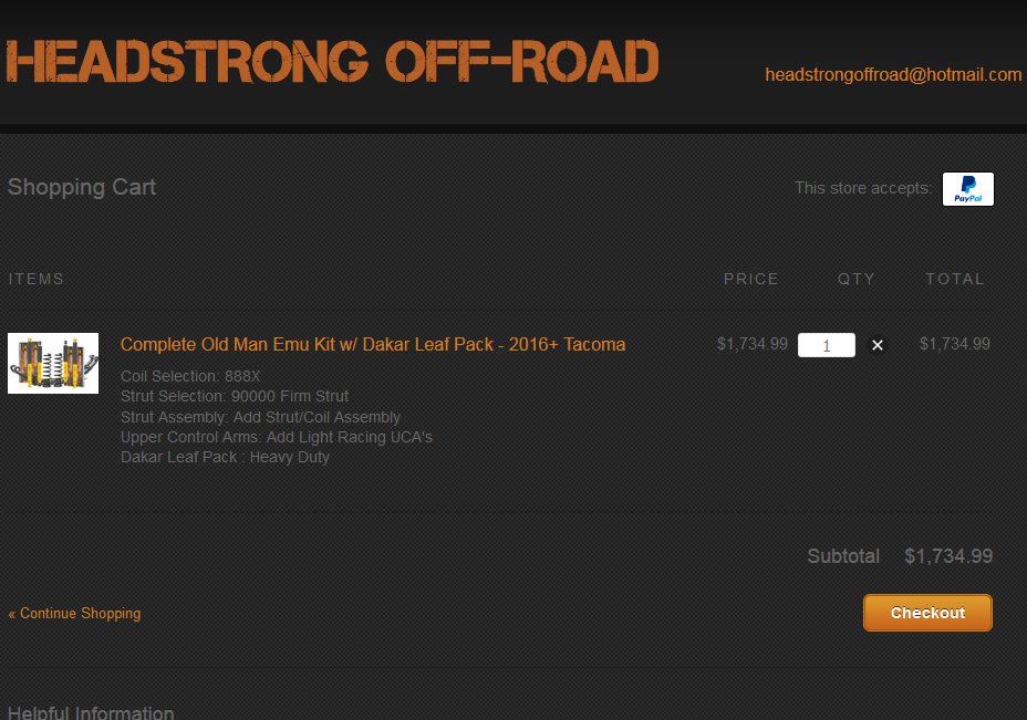

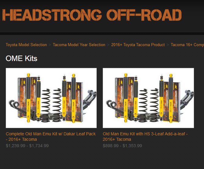

    Ok, 888 coils, 90000 strut with HD Dakars it is. I really want to achieve the leveled 3" lift along with offroad handling. Should I go with the light racing UCAs that Headstrong offers in their kit or a different brand? What would you guys reccomend for something thats affordable thats good quality?

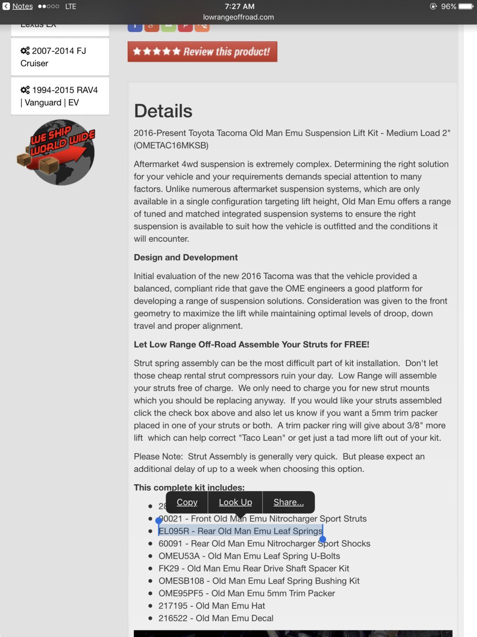

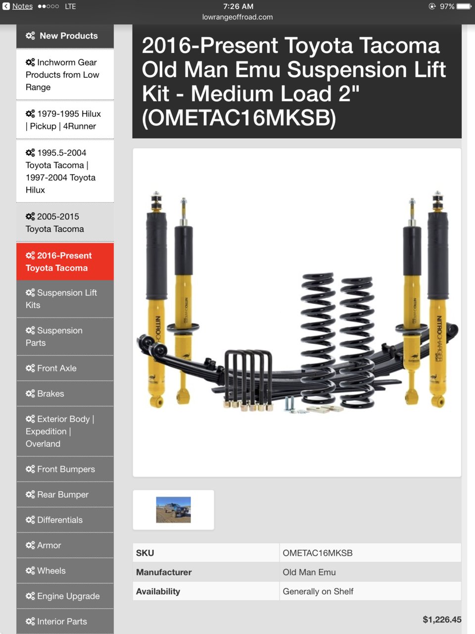

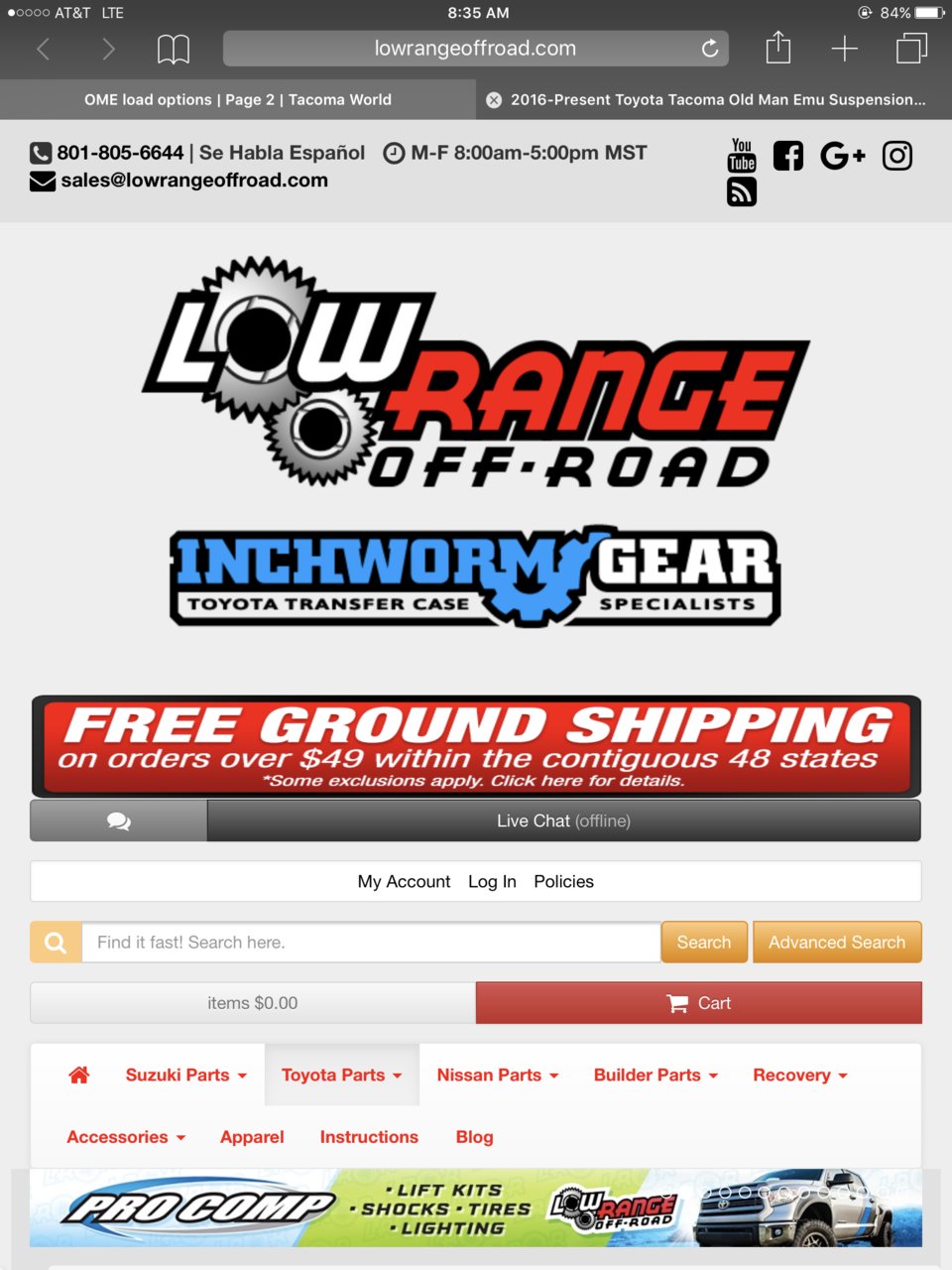

    Looks like the EL095R Dakars are included at $100 less than HS unless they give a discount from their website prices?

    I would look at shipping costs for low range. After shipping, it might be close to HS.

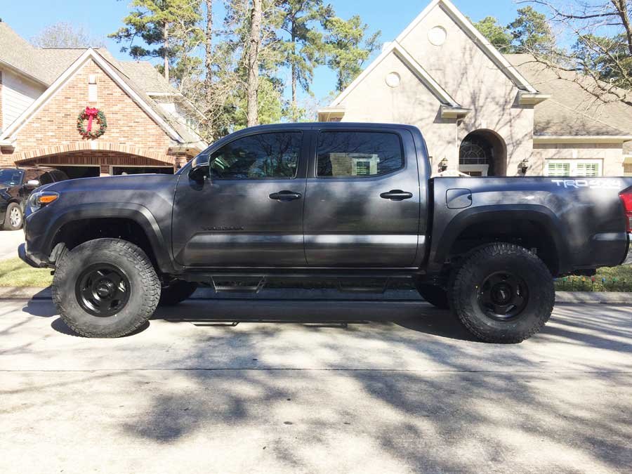

    I have a 17' DCLB and I'm currently running OME 887,s on the firmer OME struts up front (no top spacers) and the heavy duty Dakar springs in back and the truck sits almost level (3/4" lower in front than rear). This allows me to clear 255/85-16's (33.1x10x16) tires on 16x8 wheels without any rub or trimming and I still have my stock mud flaps on the truck.IMG_20171006_120352774_HDR.jpg

    Free Shipping

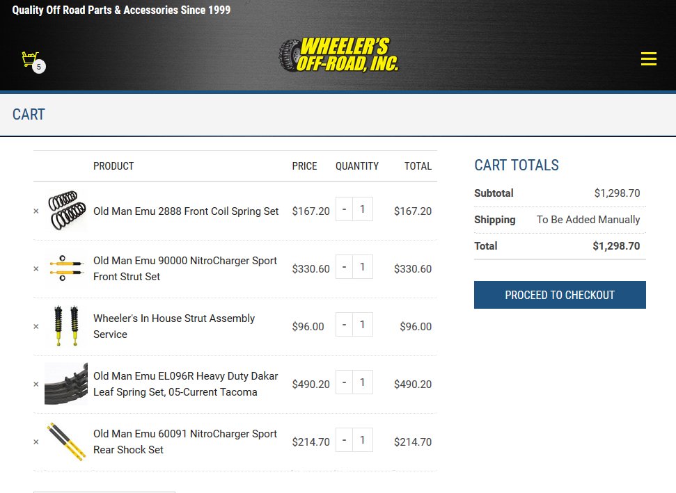

    Found this on Wheeler's offroad inc.
    This seems to beat Headstrong by a couple without the UCA.
    Am I trippin? How much are LR UCA alone anyways?

    Yes. That's $72 more than the Lowrange price I attached above. Also the HS page has LR UCA's the Wheelers page does not include UCA's. SPC UCA's at HS are $485.91 they are $485.91 at Wheelers also. So it looks like Lowrange has them both beat
