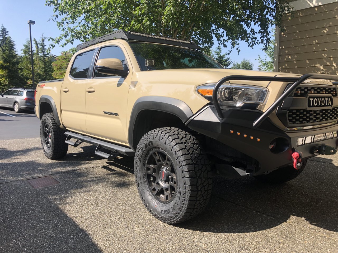

    Good lift, truck is extremely capable after the lift. Running the 886 spring, the ride quality is plush on road with the soft valving. I run no sway bar, and feel it rides even better. The rear Dakar EL096R do squeak when dirty, if you clan them not so much but it does make noise. Running 285/75/16, blue truck pictured is exact same lift with 285/70-17

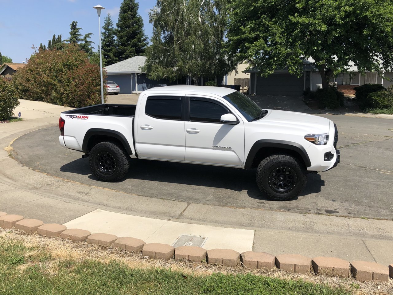

    I will order the old man emu lift today? And what else have you done to your truck. This is my truck at stock height with 265/70/17

    Just the Ome kit like you have planned. Cab mount chop, and cam tab plates. Looks just like my truck lol
