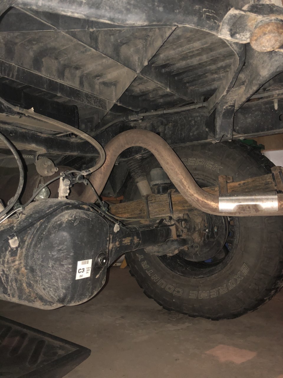

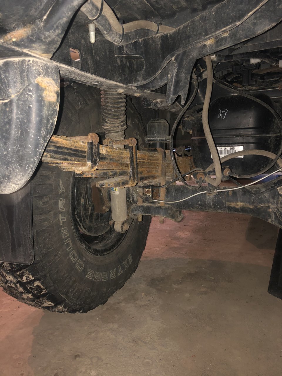

    These are the old CS047R leaf packs (equal to the current heavy) with the OME D29XL aal. They sagged a bit and then are negative arch or “W” as seen in the pictures after only 2 years. The truck only has about half the weight in the back that it does during camping season. Not impressed and will be switching to the Deaver Expedition stage 3 pack for this year.
    7D3B250D-CF0B-4BAC-AF0B-9670973BB768.jpg 51196AAF-D64A-4AE7-8FB9-320ACD75C9BF.jpg
    Truck unloaded
