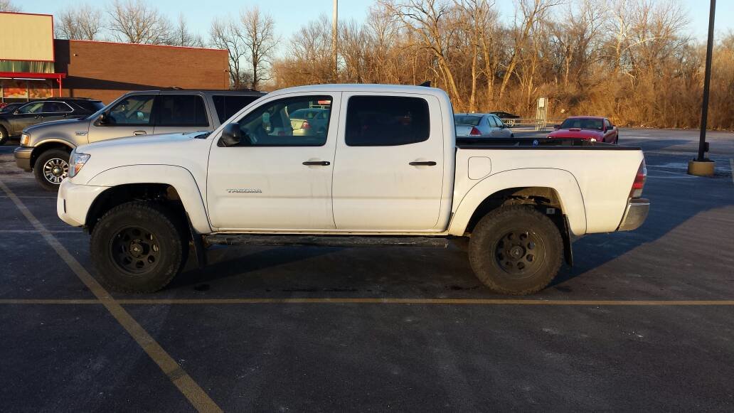

    Just in the process of putting 887s paired with OME n140s on my DCSB. Got 887s on Amazon for $157 shipped from East Coast Jeeps. I'll let you know how it turns out.

    This pic is a little difficult to see. 2887s, OME N140S with trim packer in front. Wheelers 3 leaf aal + factory 3/1 + OME N182 in the rear. The back looks a little lower than the front, but it has about 300 pounds of wood and tools in the bed.

    Thanks for the photo Josh.
    Currently waiting on Headstrong to give the the word that the 887s made it off the California docks, didn't want to tie up my money in case I decide to go a different direction.
    Second guessing Dakar springs an considering less expensive AALs. I'd ultimately go with which ever gave the best ride an about 2.5" of lift, unloaded with my tonneau.
