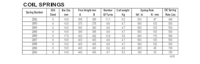

    can some one tell me if the ride quality is any different from the 885 coils to the 887?

    2,770
    Cade
    So. Oregon
    Supercharged '14 Pyrite Mica DCSB 4x4 TRD OR
    Stacked spacer lift, 22x12 wheels with stretched 33's, tow mirrors, bull nuts.
    As far as I know.... Nope, same spring rate. I love my 887's.

    mostly stock, grocery gettin' Prius
    Correct. Just 15mm taller for the 887s IIRC

    50,587
    Peter North
    British Columbia
    5mm

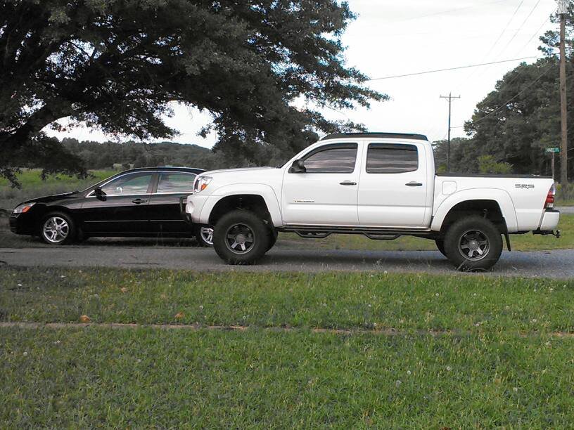

    I would go with 885s.. reason?.. Dakars will settle some.. despite what some say... unless you plan on doing the Dakar aal I would suggest staying with 885.. get the top plate spacer.. then when the rear settles.. have a different option than buying more items.. I have 885s with top plate spacer Dakars in rear.. granted I'm a prerunner.. but I had 25 inches from hub to fender front and back.. two weeks later Dakars settled and had half inch bro lean.. took top plate spacer out and now slight rake but mostly level84e076cc55fba3dc95364e03e2d336df_a9284f21b247d68dfb134aa4f63d4030f5bb2cc3.jpg

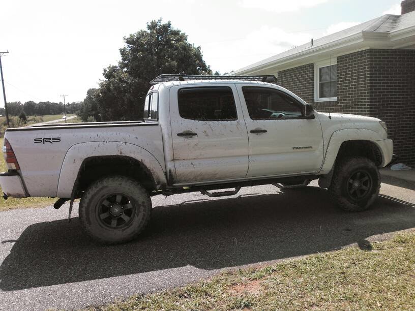

    That photo is with top plate spacer.. this picture is without5a55db7b0a1b69a5bfa6074fdd6133c5_918d52e01a3346b5ae0a6140e9b473828bb3b6b9.jpg

    I will say that if you are going to carry constant weight on the dakars you should get the add a leaf that goes with them. I installed 5100's with 885's in front and dakar leafs in the back last weekend. She sits level or has slight rake. Haven't measured hub to fender yet and the ground in my pictures is sloped up towards the front of the vehicle. I am a 4cyl. 4x4. Focus on the wheel well differences in the two pics as the tires are the same.
