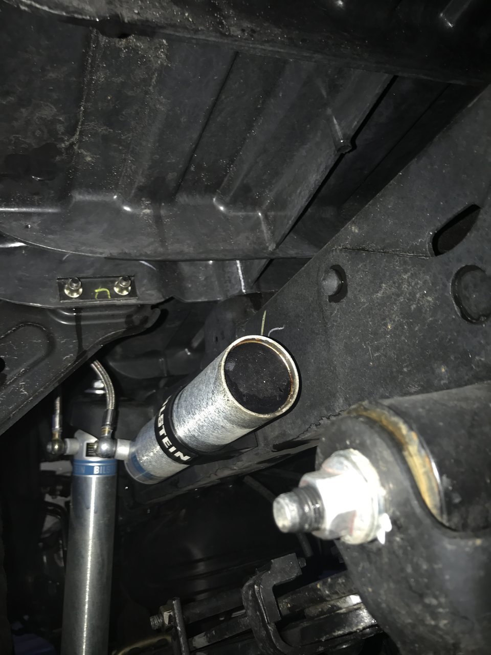

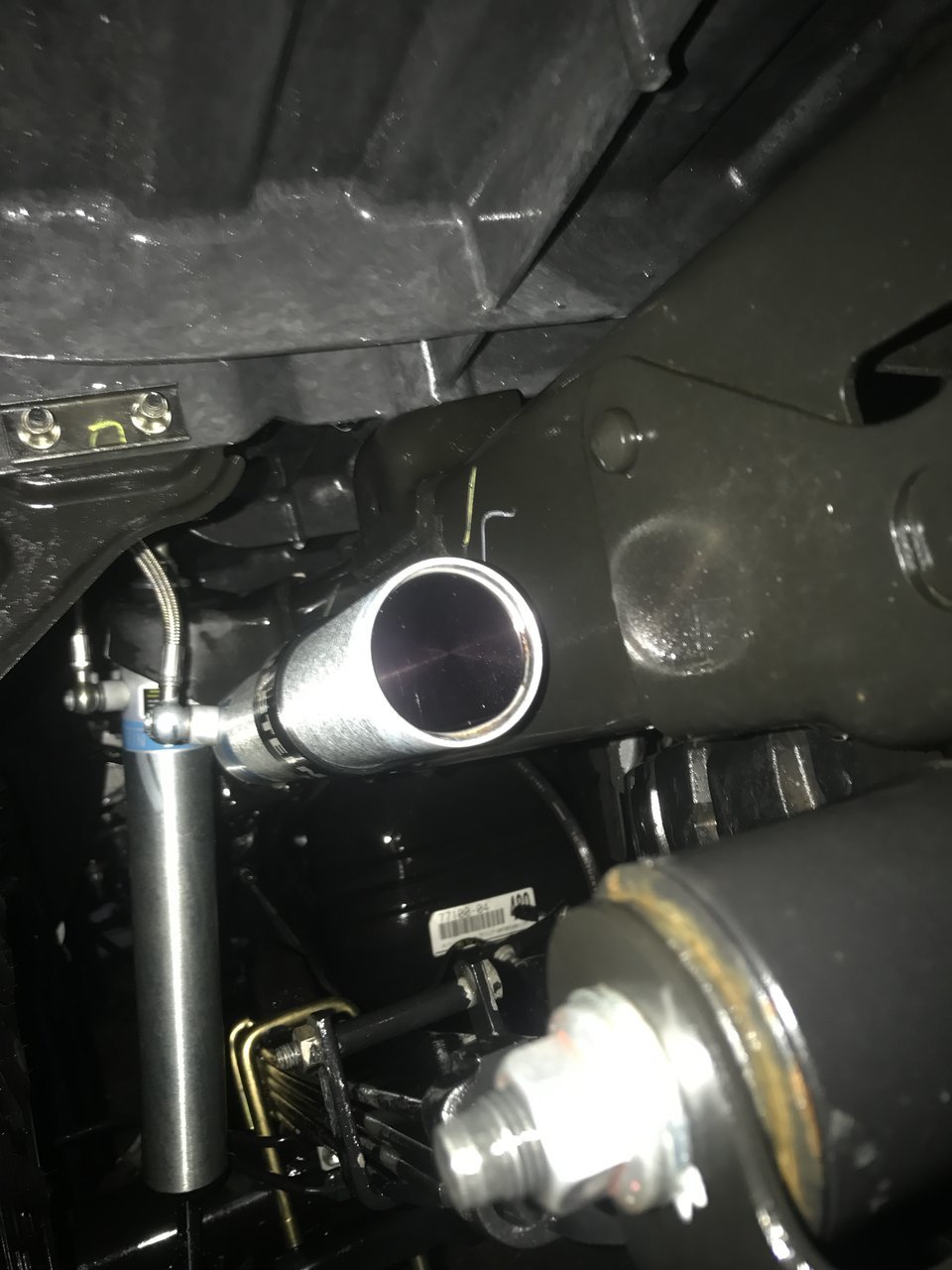

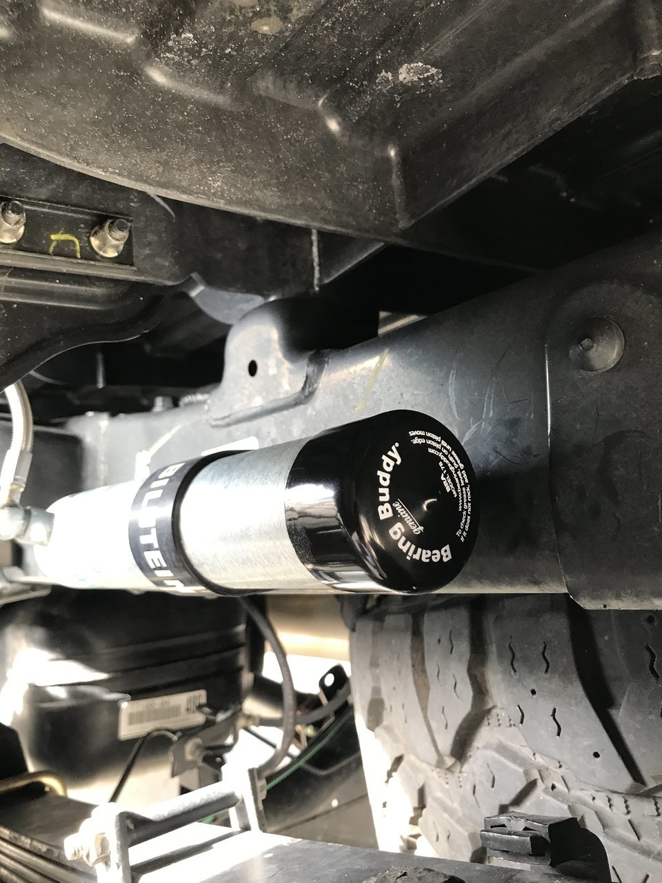

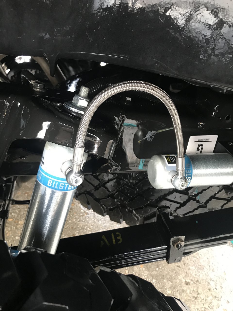

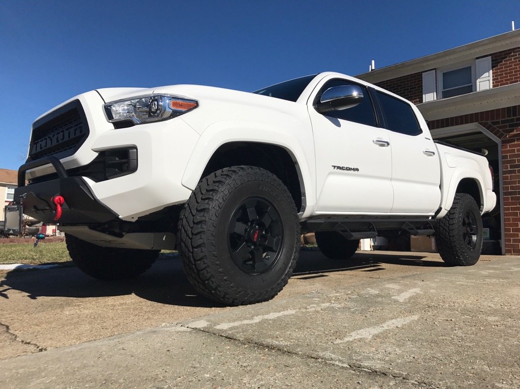

    Cons: vulnerable rusting spots from salted roads after snowfall. But they can be easily fixed with any rust remover.
    After
    Invest in a bearing buddy 17b to avoid rust buildup.
