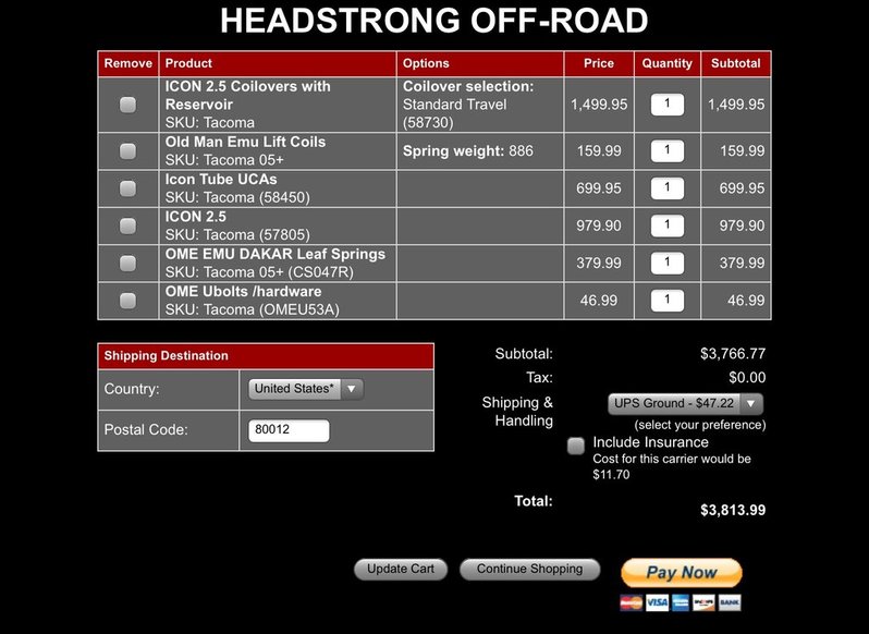

    This looking solid? And will I need the extended brake lines for this set up, or is that only if I were to get the extended travel shocks?
  8. Oct 15, 2015 at 10:39 AM
    #28
    RogueTRD
    RogueTRD Learn to swim...
    Aug 11, 2011
    #61546
    2,770
    Cade
    So. Oregon
    Supercharged '14 Pyrite Mica DCSB 4x4 TRD OR
    Stacked spacer lift, 22x12 wheels with stretched 33's, tow mirrors, bull nuts.
    No need for the OME lift coils, the Icons are a full adjustable coilover. You don't really need the 2.5 rears, you can get the 2.0's and save quite a bit of money. I would call Wheelers or Headstrong and they can talk you through what you actually need. You will need extended rear brake lines and make sure you get the custom length rear Icons for the Dakars.

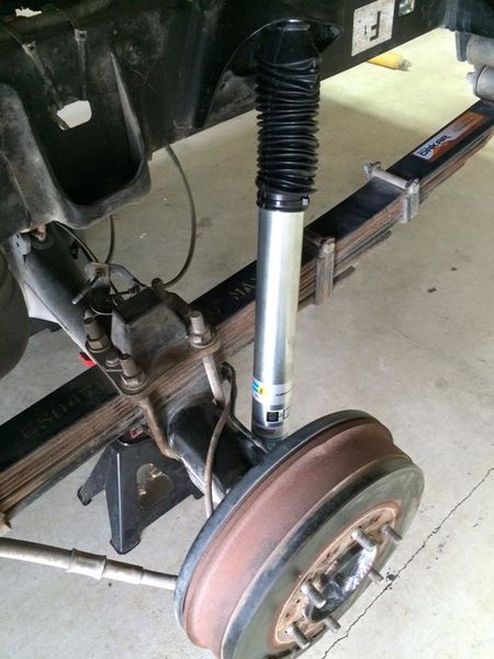

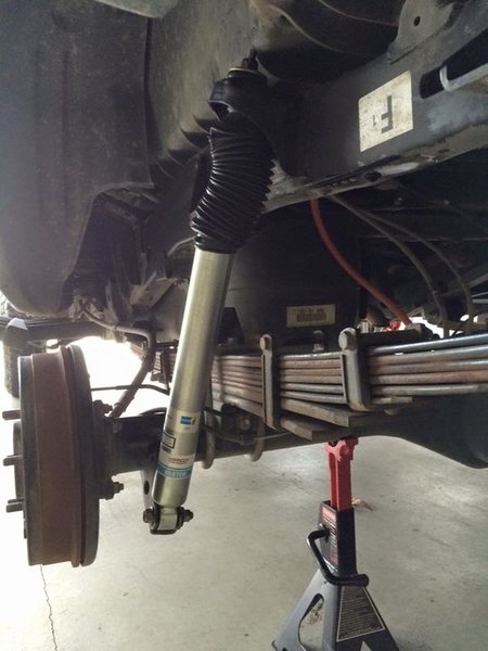

    Front:
    Bilstein 5100
    OME 887
    All Pro UCA
    Rear:
    Bilstein 5100 Long Travel 16.34"-27.28" (BE5-B110-T5 X2)
    Dakar Leaf Pack with D29XL
    ATO shackle flip
    ATO stock length HD shackles
    Extended brake lines
    All Pro Ubolt flip
    ..... :cool:
