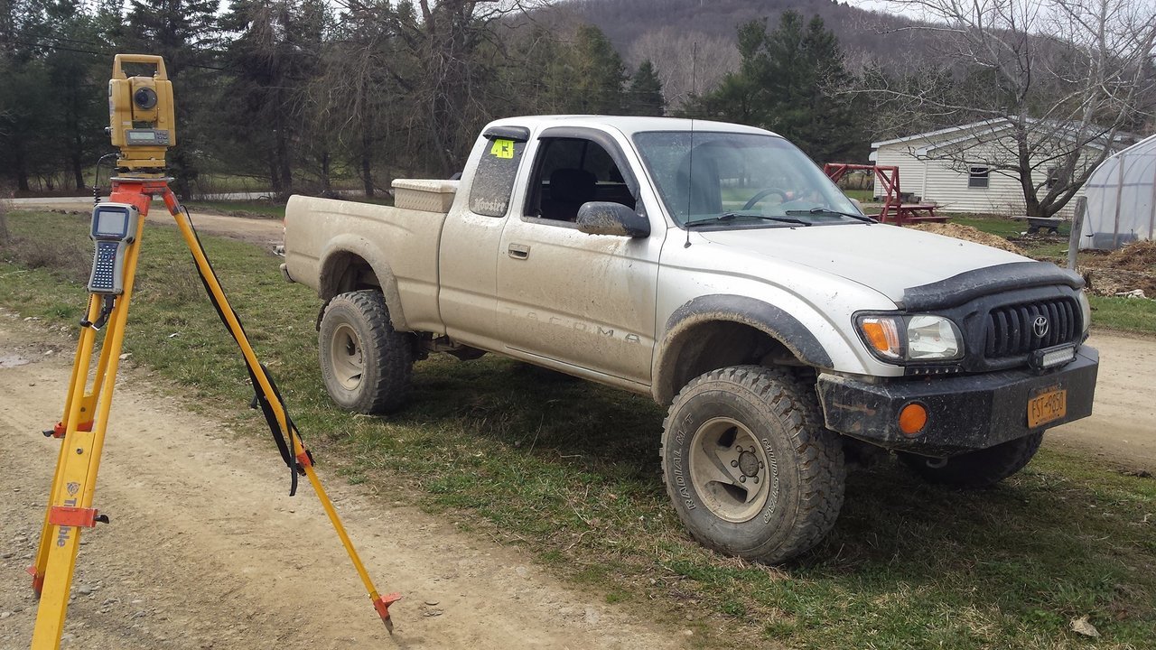

    The setup will be mostly on road with occasional off roading for camping or hunting trips. Will also have the weight of leer cap and sleeping platform. I'm also wondering how similar the lifts look on the trucks? I haven't seen many photos of tacos with ome

    Thats mine with the OEM Dakar springs in the rear. They are a little stiff but i like them, I can fill it with slab wood and it barley squats. Way better than stock springs.
