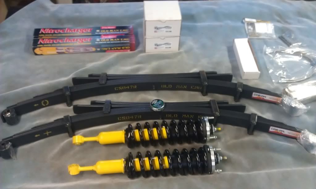

    Mine goes on tomorrow! :woot: I'll let you know if I run into any problems doing mine. Does anyone know if you need anything to separate ball joint on the UCA from the spindle when installing the new UCA's? I'm trying to get all the tools together today that I will need to do the install. I'm doing mine at work so I need to make sure I have everything with me.

    Murph, is there a specific installation thread(s) you will be referencing during your installation? I've been reading this thread from bjmoose and it seems like it will be helpful when the time comes, but he has a regular cab (vs. double cab - not sure if there are any major differences for a lift install): http://www.tacomaworld.com/forum/su...talls-full-ome-kit-rear-brake-lines-pics.html.
    A list of tools would be very helpful too, if anyone can compile something like that for us.

    I just noticed you have different markings on your springs than me. I hope I didn't get the wrong dakars. Yours have a circle with an arrow on one and a plus with an arrow. My set doesn't have the circle just a plus on each one and an arrow on one. wtf?
