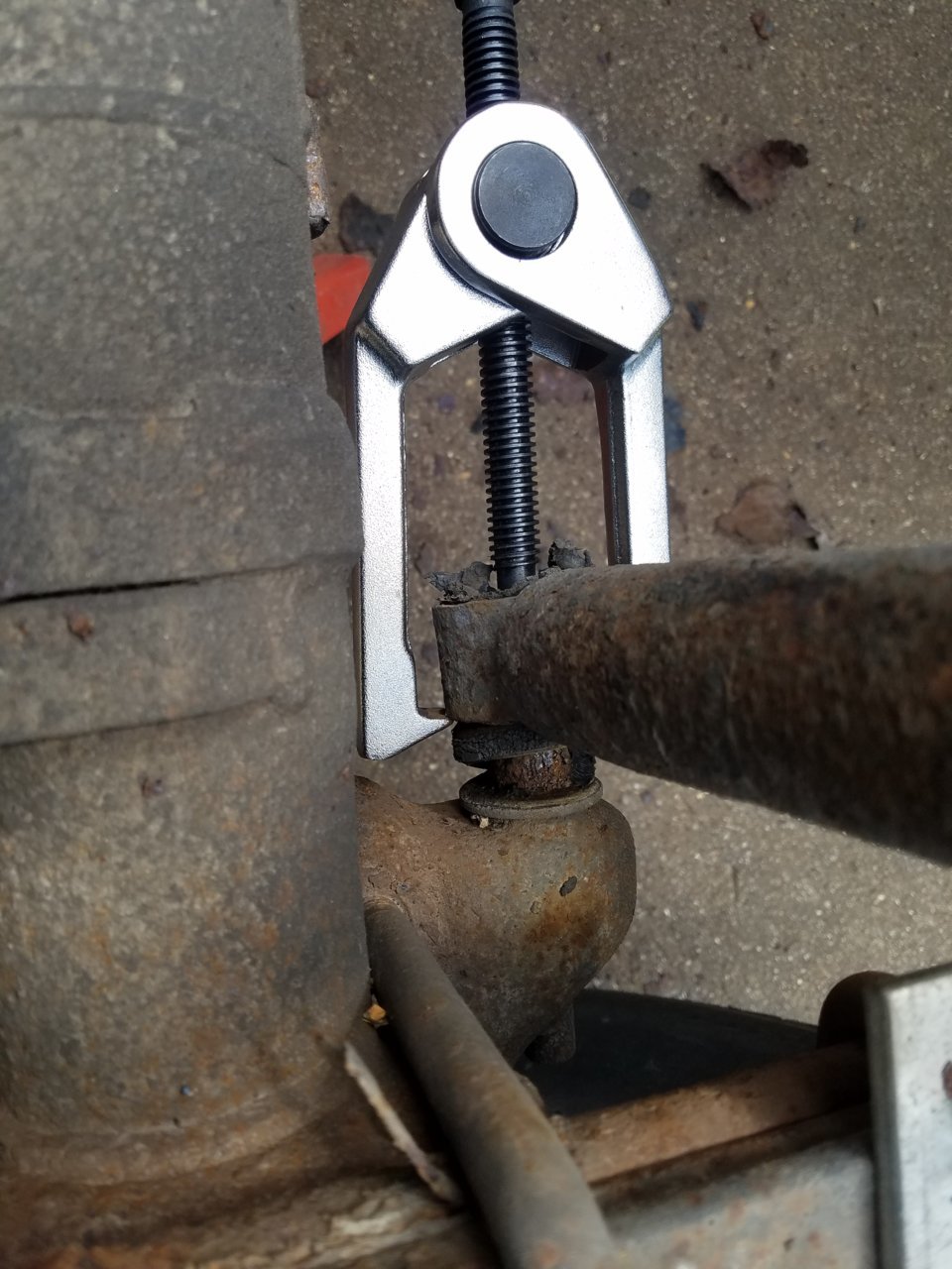

    You could likely use a puller (Autozone/O'reilleys) and a washer the same diameter as the bushing. When you tighten the puller down, it should push the pushing out the back side.
    I am going back to the garage after supper, I'd mock one up and take a picture.
    Edit: I just used a puller to get one of my shocks off about a week ago. A washer placed in there if the shock was off the vehicle, I think it would push the bushing out the back side.

    You have a link to that puller? It looks better than the usual 3-jaw that is always falling off stuff.
