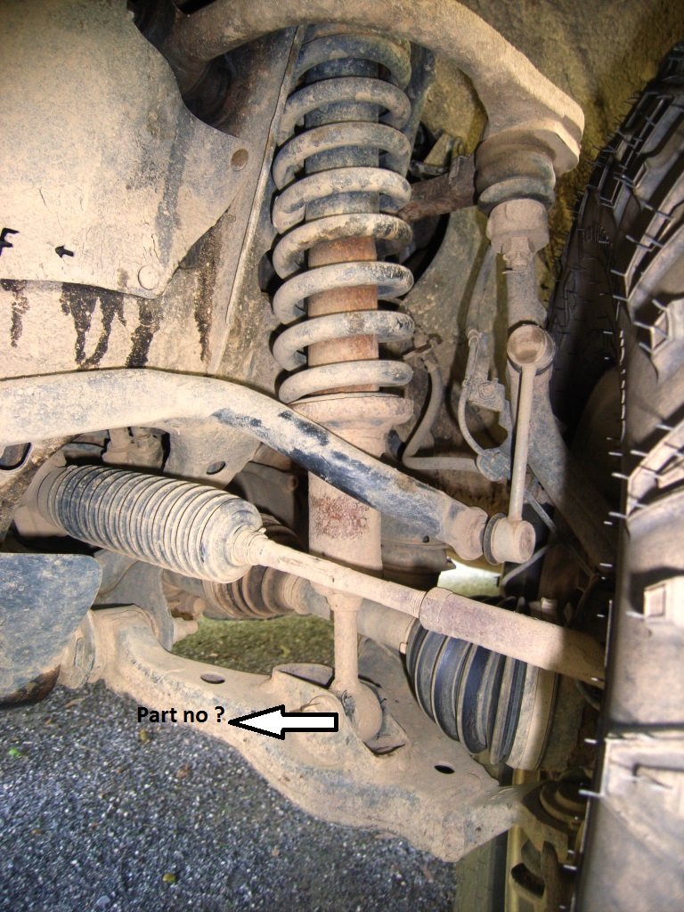

    Anybody can confirm the part # for the lower bushing on OME 90000 shocks (see pic)? Looks like it might be part # 110-110-122 but I would like to confirm before ordering. The answer I had from a parts shop is pretty vague. Also, any other replacement bushings that would fit?

    You are correct.

    Since I'm in Canada, I have limited options. The bushing was ordered from these guys: http://www.tdotperformance.ca/. It took a few weeks to get it, they probably don't stock them. I think I might of tighten the bolt too much before lowering my taco when I installed my shocks thus binding my drivers side bushing and tearing it to shreds after 80K km.
