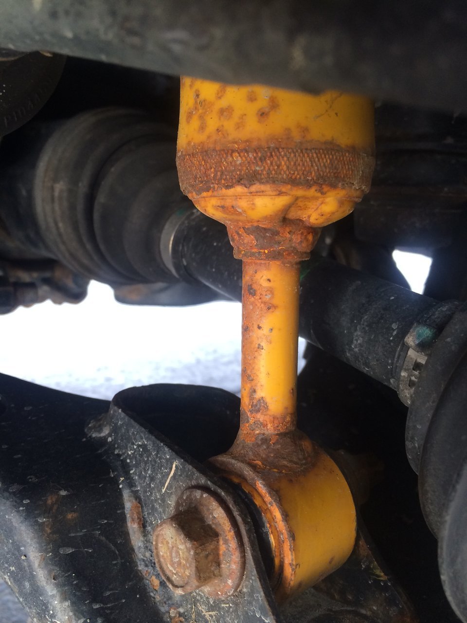

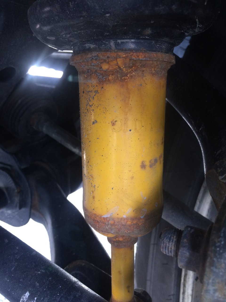

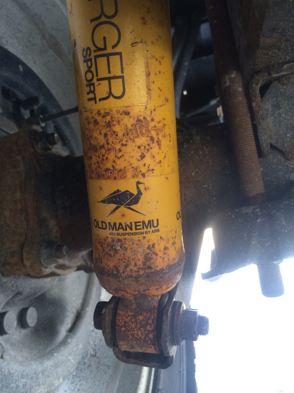

    Let me know if the attached pics error out... But this is from my last truck, shocks were new in October and these pics were from December/January I want to say. Granted this is October 2013 to April 2014 so they might have updated the coating on them. But judging how the paint blew off of my new leaf springs I don't have much confidence in their coating department. Buy the Bilsteins and get the NH Oil Undercoat or something similar and you wont have to really worry about corrosion
    Correction: Pics are from April 14 not January 14
    EDIT: Will add I did reach out to ARB USA about this, and got the "Due to the North East Climate you should wash the shocks regularly blah blah... and we won't cover any coating warranty due to road salt and environment" kind of tough to wash the truck in the middle of January

    this makes me rethink everything....

    I don't want to sound like the negative nancy but I ended up getting 40ish,000 miles out of them. Ended up blowing apart the internal valving. Could take the shock and rotate it and hear the oil sloshing back and forth. Will correct that these pics are from April 2014, they went in October 2013.

    Thanks for the reply and pics. They go along with other posts I've read along the way.
