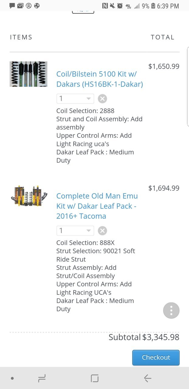

    Trying to decide on this myself

    You could do billies in front with your coils and ome in rear with dakars to avoid extended brake lines and new bumps.
    Errrrr....looks like you fgured it out

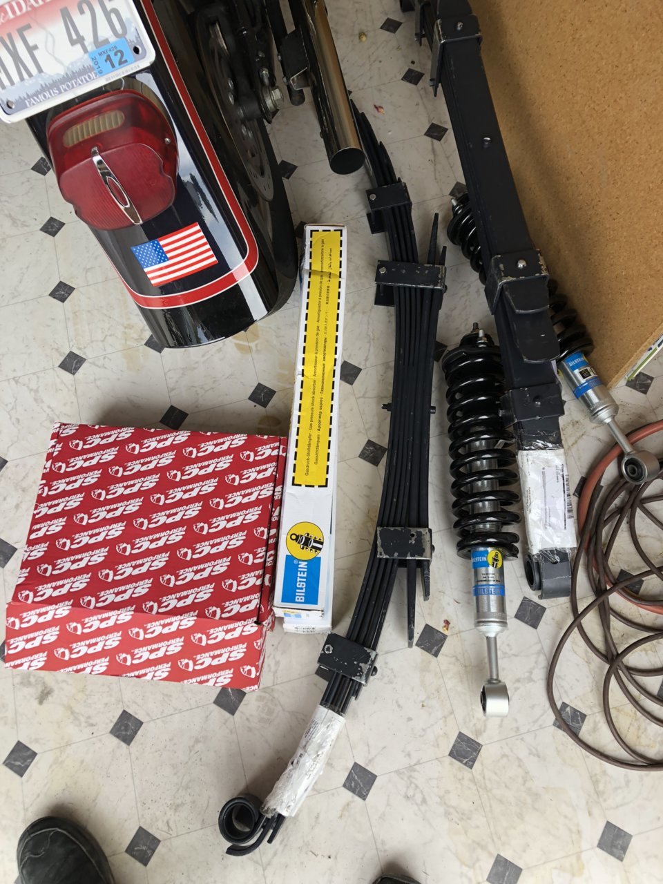

    Hopefully this week I will get some time to let the fun begin!! IMG_4626[1].jpg
