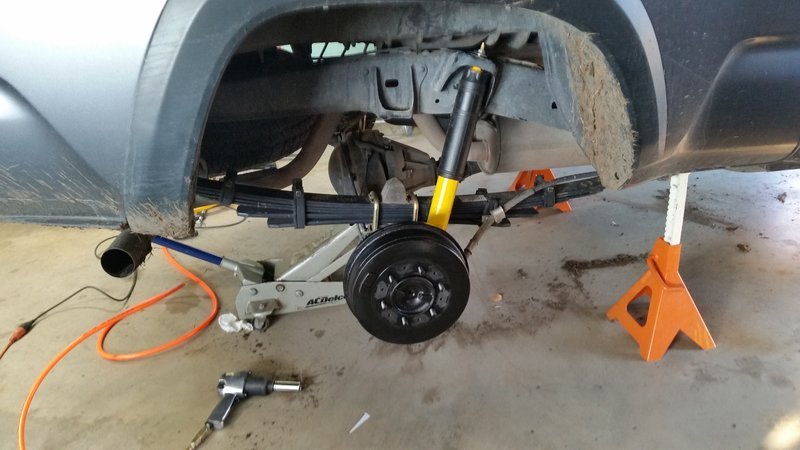

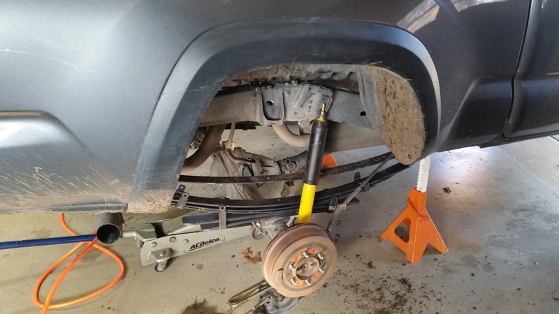

    All apart and 3rd leaf missing.

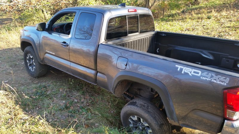

    Still droops to the limit and dangles a tire over the hole (no surprise, but I was testing)
