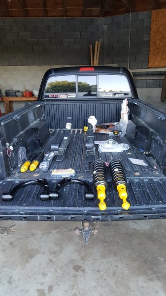

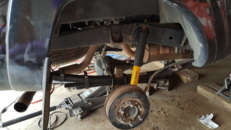

    Hey everyone. I'm currently installing a full OME kit in my access cab tacoma.. I'll get more pictures up but a couple quick questions. The factory bump stop does not seem to fit well on top of the bolt on the new leaf packs. Do I just drill out the bump stop, or discard it? Also I am not 100% sure how the assembly goes on the top of the rear shocks. I think I have the order correct but I will post a picture once I'm out there. Thanks!

    You can drill the bump stop or cut the U bolt. I'd suggest drilling them, it's super easy and leaves you enough meat on the U bolt if you need to add shims or an AAL later.

    Drill the bump stop, it's the easiest thing to do :)

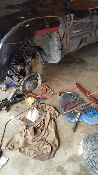

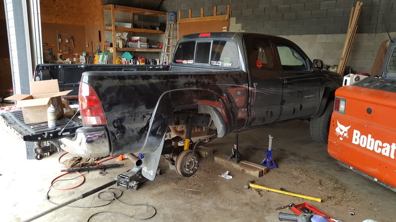

    I drilled the bump stops, got the rear end all assembled tonight, with Nitrocharger sport shocks. Sorry for the lack of pics. I'm dead tired, but he should get some up whIle tackling the front tomorrow. Any important things I should note before installing the new UCAs and coI'll overs?

    Get ready to bend the piss out of the sheet metal to get the bolts out and don't tighten them all the way until the full weight is back on the tires. If your fronts are already assembled just be ready to put some extra pressure on the LCA to get it in there. If they're not, just be careful disassembling/reassembling. Springs carry scary energy.
    The worst part is the Dakars so if you have that done you're good from here on out.

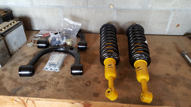

    Now it's time for some spidertrax wheel spacers. Then I'll get to see how it sits. Thank you, everyone for the tips and replies. More to come on the front end

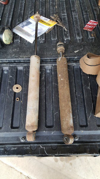

    Take a look at the totally garbage rough country shocks that come off it. About 4 months shy of a year they were on there, and around 12 thousand miles

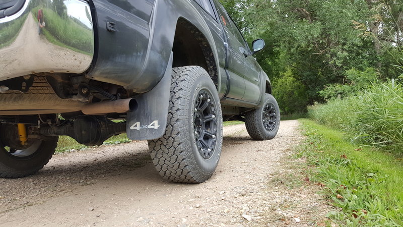

    Here's the final product

    Looks good
