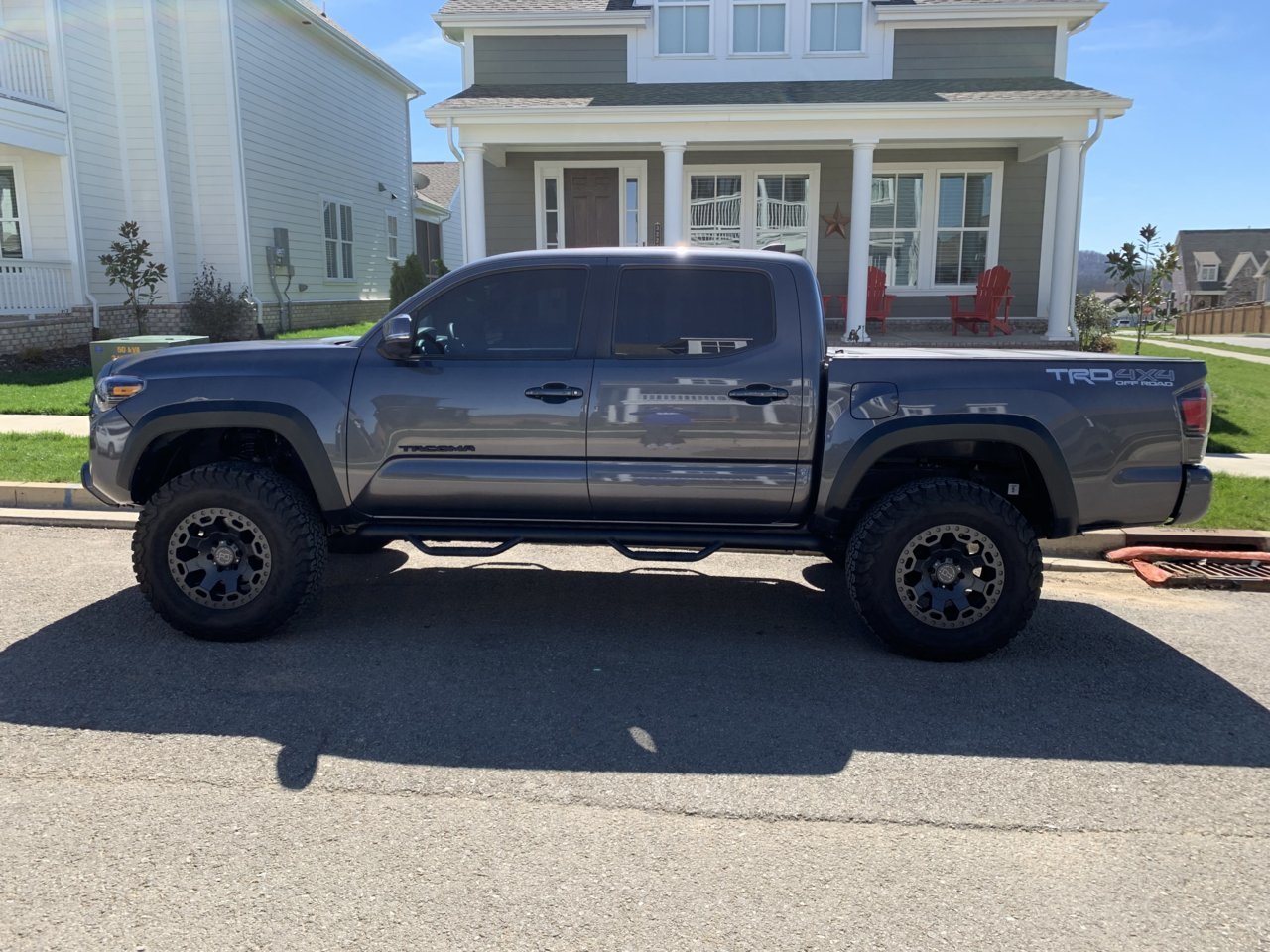

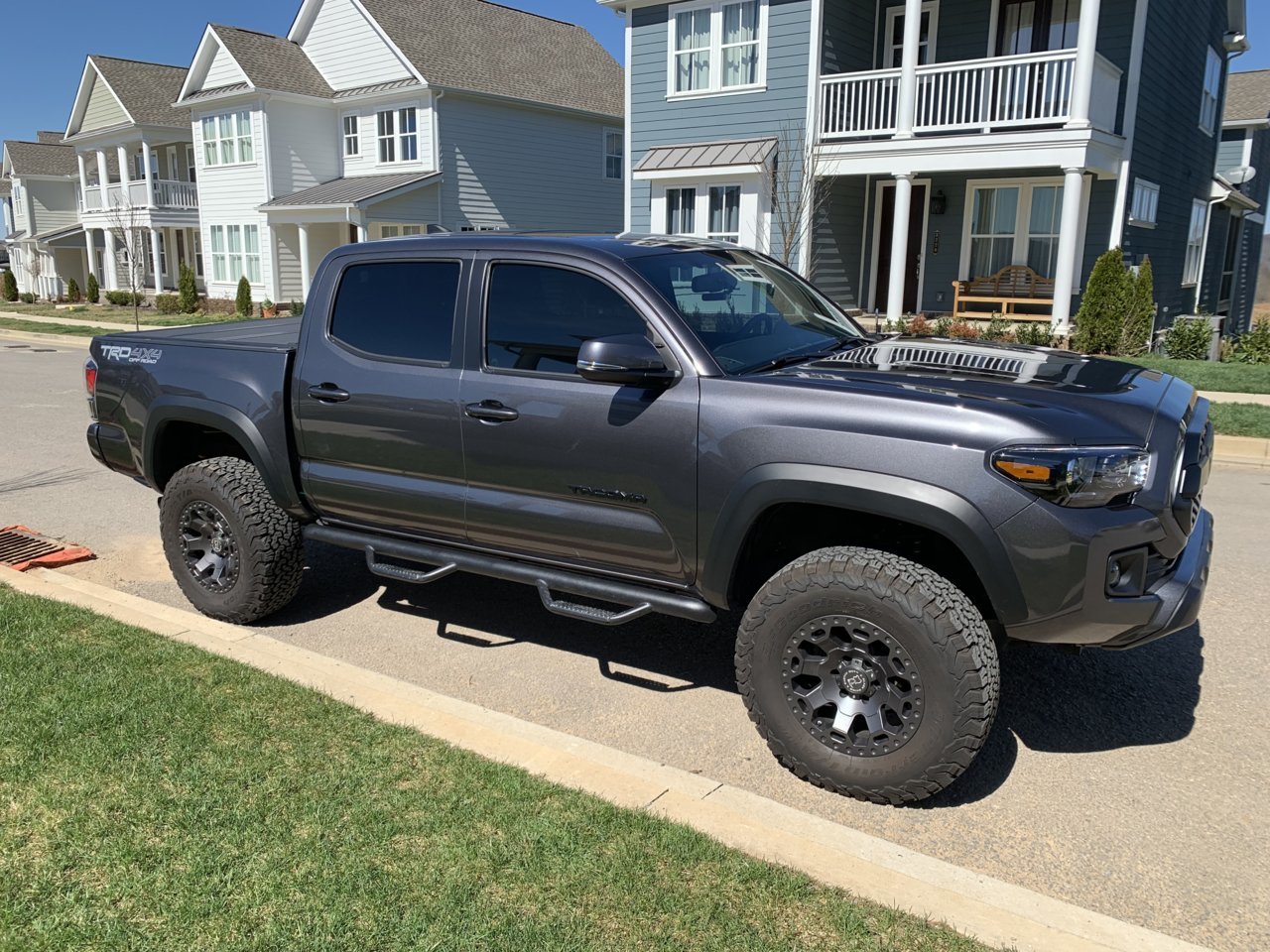

    That is the lift I went with but instead of AAL I did a full Dakar pack. Sorry the shadows kinda suck on these pictures.

    thanks man! looks perfect! dakar "medium duty" right?
  4. Mar 28, 2019 at 11:40 AM
    BlueDevilPharmD
    BlueDevilPharmD Well-Known Member
    Dec 22, 2018
    #276661
    262
    Nashville
    2017 Tacoma TRD Off Road
    This is the HD pack with the second overload spring taken off. Still gives a little rake. I will answer your PM as well.
