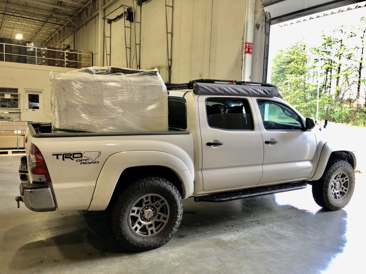

    Thinking I'll be making the jump sometime soon as well. Currently have OME HDs, and the squeaking is driving me insane and they're totally flat. Even though I know OME says that's normal, I'm ready to move on. I have a rear high clearance coming soon, so the added weight is going to necessitate a change. Right now I'm torn between state II or stage III. In terms of weight, here is where I am:
    Constant weight is 620 pounds:
    • Prinsu Top Rack: 50 pounds
    • ARE cap: 175
    • Homemade bed drawers: ~150 pounds
    • Rear bumper: 170 pounds (although this doesn't take into consideration the stock tow hitch that is removed, so it is likely less than that overall)
    • Tire and wheel on the rear swing out: 75 pounds (again, the stock spare will be removed so maybe closer to a 50 pound increase overall
    In the summer months when the truck is setup for weekend camping trips, add another 300 pounds:
    • CVT Mt. Hood 50" RTT: 140 pounds
    • Dometic CFX3 75DZ: 61 pounds
    • Alu-Cab tilting fridge slide: 26 pounds
    • Other misc. camping gear: 75 pounds
    So for half the year I'm easily around 900 pounds, and the other half I'm around 600. I winter camp too, so a lot of times I"ll add the RTT and then get lazy and leave it on for a month. So its probably more like 8 or 10 months out of the year I'm close to 750 pounds minimum.
    I'm thinking I'd get the stage IIIs. I don't care if the ride is a little stiff in the off season. Worst case scenario it should be possible to remove a leaf from the stage IIIs right?

    Man I must be the one lucky guy who loves his Dakars. Never any noise, no sag after 5+ years, ride great loaded and unloaded.
    #2000 in the bed
