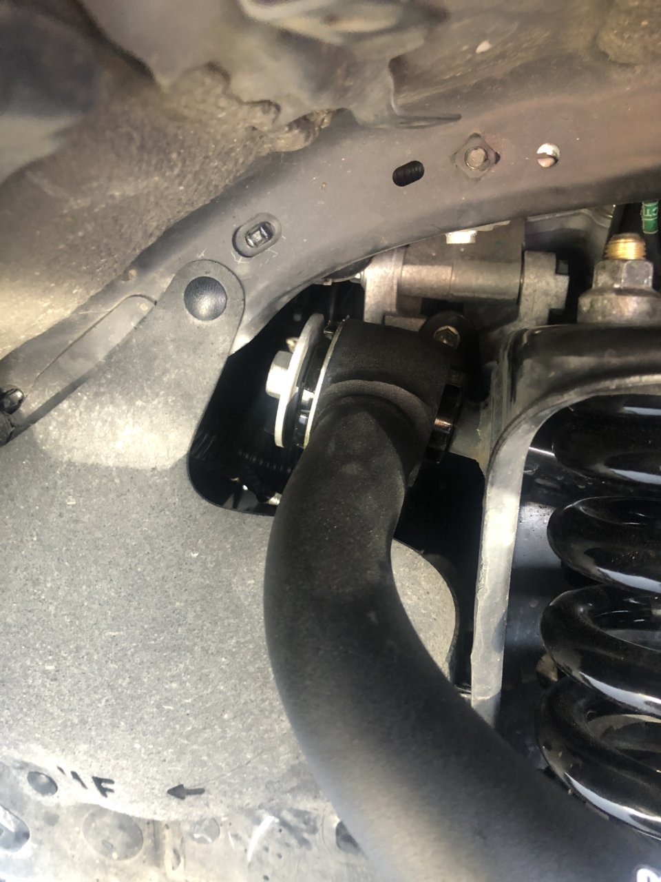

  3. Apr 6, 2021 at 4:12 PM
    #23
    Geraldini
    Geraldini [OP] Member
    Mar 27, 2021
    #360763
    18
    2017 gray trd offroad
    Bilstein 6112/5160 Dakar hd
    Just got off the phone with arb armed with some of the info we have covered on here. ARB is saying the first gen arm sleeves are 3mm too long and either need to be ground down or swapped with their gen 2 ones (back ordered a few months). I’m not missing any washers and it’s installed correctly the issue is the inner sleeve being too long. Thanks for the help though.

  6. Apr 8, 2021 at 10:01 AM
    #26
    Geraldini
    Mar 27, 2021
    #360763
    18
    I will say ARBs customer service is top notch. They acknowledged the issue and have said they will replace. The arm is great other than the sliding issue caused by the bushing sleeve being 3mm too long which is said to be resolved in their second generation arm. It aligned with zero issues, handles well, its beefy, greasable, and looks good. I would just swap it with a new one if it was readily available but can’t wait until august for the new arm. I went against the forum grain and wanted to try something new. All in all if you are in the market for new arms this fall I would recommend the ome uca.

  10. Apr 8, 2021 at 10:25 AM
    #30
    Geraldini
    Mar 27, 2021
    #360763
    18
    Yeah I read that one before. The difference is on these is that I have them torqued completely and the bolts are installed the way they come from the factory. The inner sleeve on the bushings is too long so it slides along that and no amount of tightening can fix it. The option is to either shave the sleeve down 3mm or send it back for the new ones.

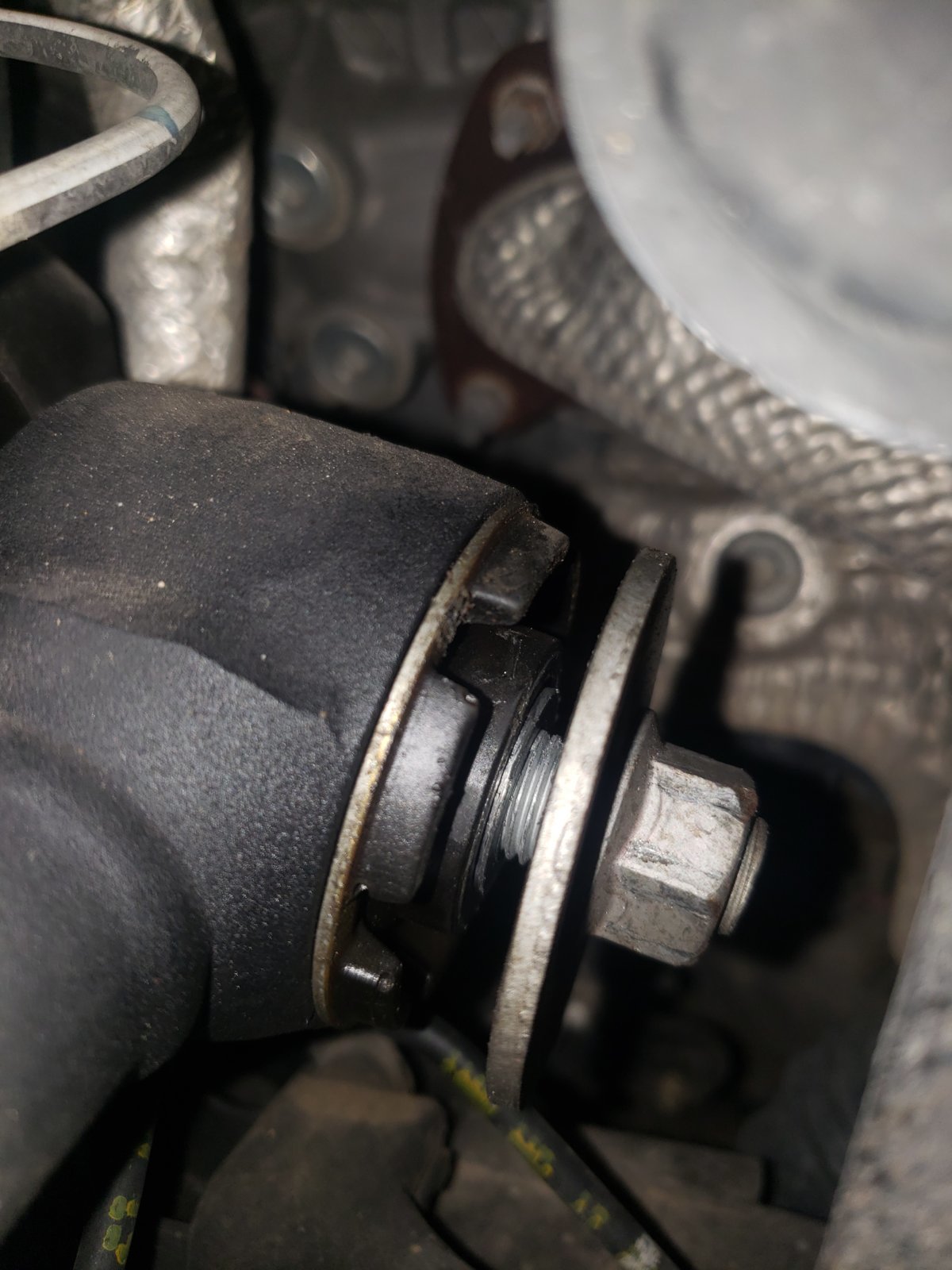

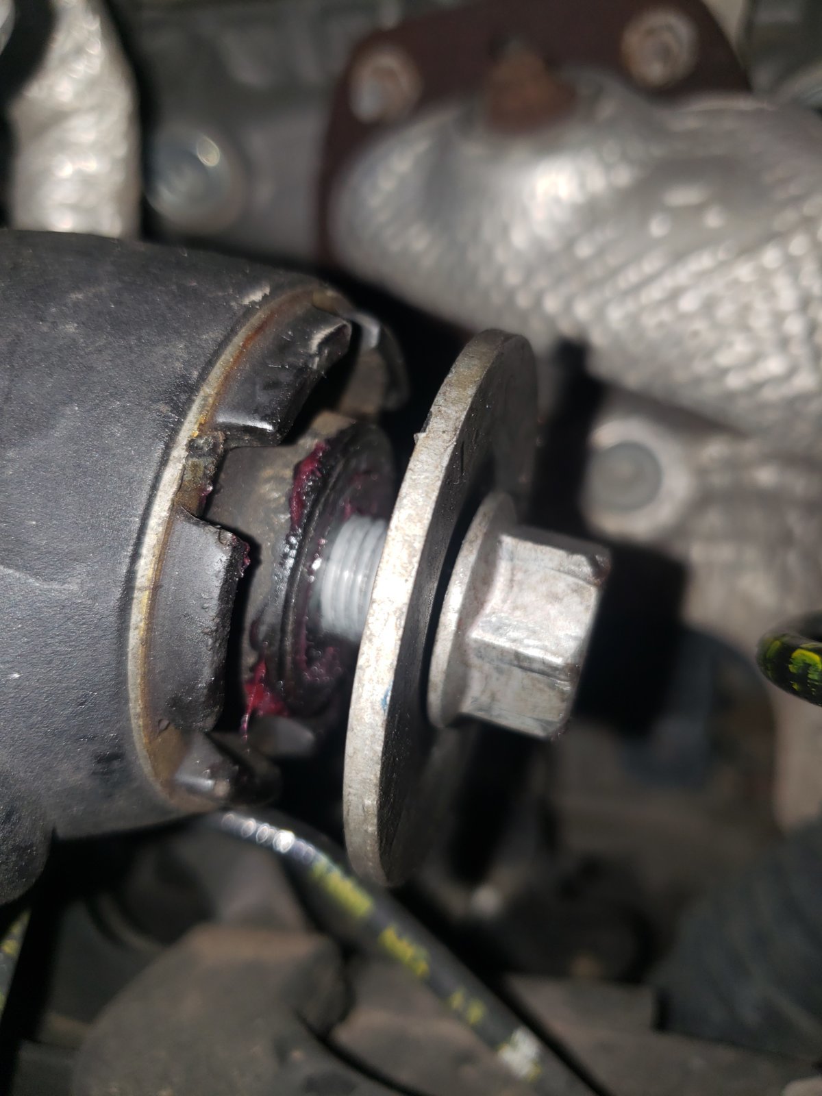

    Just found this thread. Had a clunk in my front end since installing the lift on my 3rd gen Taco back in 2020. Most noticeable while turning and going over bumps, and especially while tire goes off driveway lips while turning. Found exactly what the OP was saying about the sleeve being too long. This pic is with the nut and washer loosened, looking at the rear of my driver's side UCA. You can clearly see the sleeve protruding from within the arm. This allows the entire arm to slide back and forth, since it isn't captured by the factory washers because of the gap. I can get a pry bar in there and easily slide the uca back and forth and the noise is quite noticeable, even with that small amount of force. I think I'm going to pull the sleeve out and grind it a tad shorter to take out the slop.

  15. Oct 16, 2023 at 4:17 PM
    #35
    veedo
    veedo Well-Known Member
    Oct 26, 2014
    #141055
    124
    have you tried to contact arb?
  16. Oct 16, 2023 at 6:06 PM
    #36
    nmatcek
    nmatcek Active Member
    Jul 3, 2014
    #133226
    26
    No. Can't find my receipt and I have no idea where I bought them from unfortunately. I guess I could still try, but their warranty policy on their website seems pretty strict so it's probably a long shot.
  17. Oct 26, 2023 at 7:57 AM
    #37
    nmatcek
    Jul 3, 2014
    #133226
    26
    Here's an update. Pulled the whole thing apart and shaved off a bit of the rear sleeve to make it flush. Successfully took out all the slop when it is tightened up.
