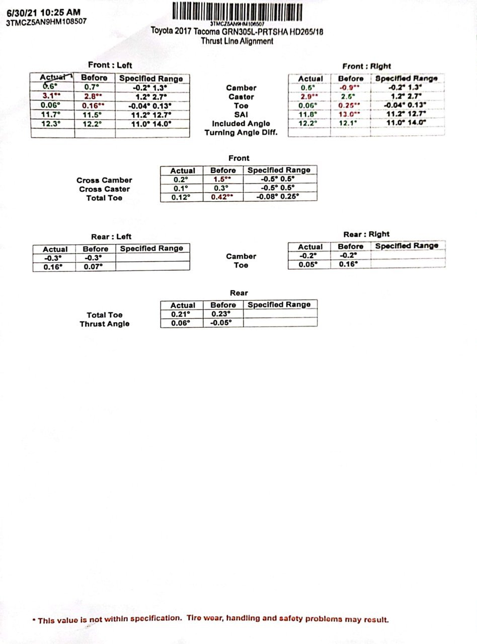

    OME provides you with alignment specs to bring your truck back into factory spec. This is what mine follows.
    My caster is slightly higher than what they call for to avoid rubbing.
    I find this alignment to work perfectly and will maintain these numbers.
    My goal when modifying any vehicle is to keep things as close to factory as possible.

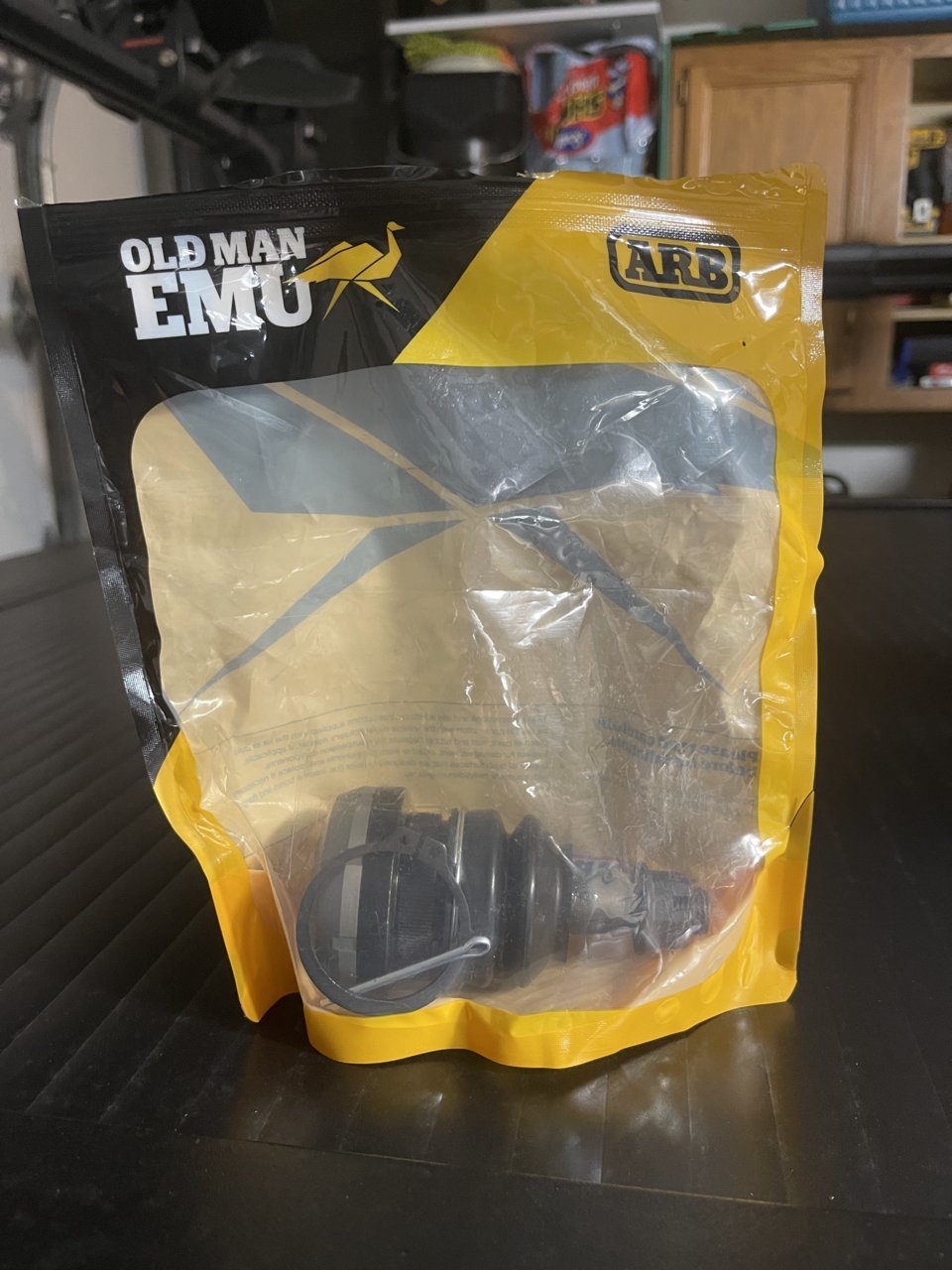

    Does anyone know if these use a proprietary balljoint or an off the shelf item? If the latter, what is the part number?
    Getting ready to pull the trigger on a full OME lift and eyeballing these for my uca.

    The ball joint part number is UCASP013

    How much per and where did you source those from?

    They came straight from ARB, there was a defect in one of the ball joints that shipped with my UCAs, so they sent this one out for free. Not sure what the cost would be if you wanted to buy one. They would’ve sent me new UCAs but I would’ve been waiting much longer since they were out of stock.
