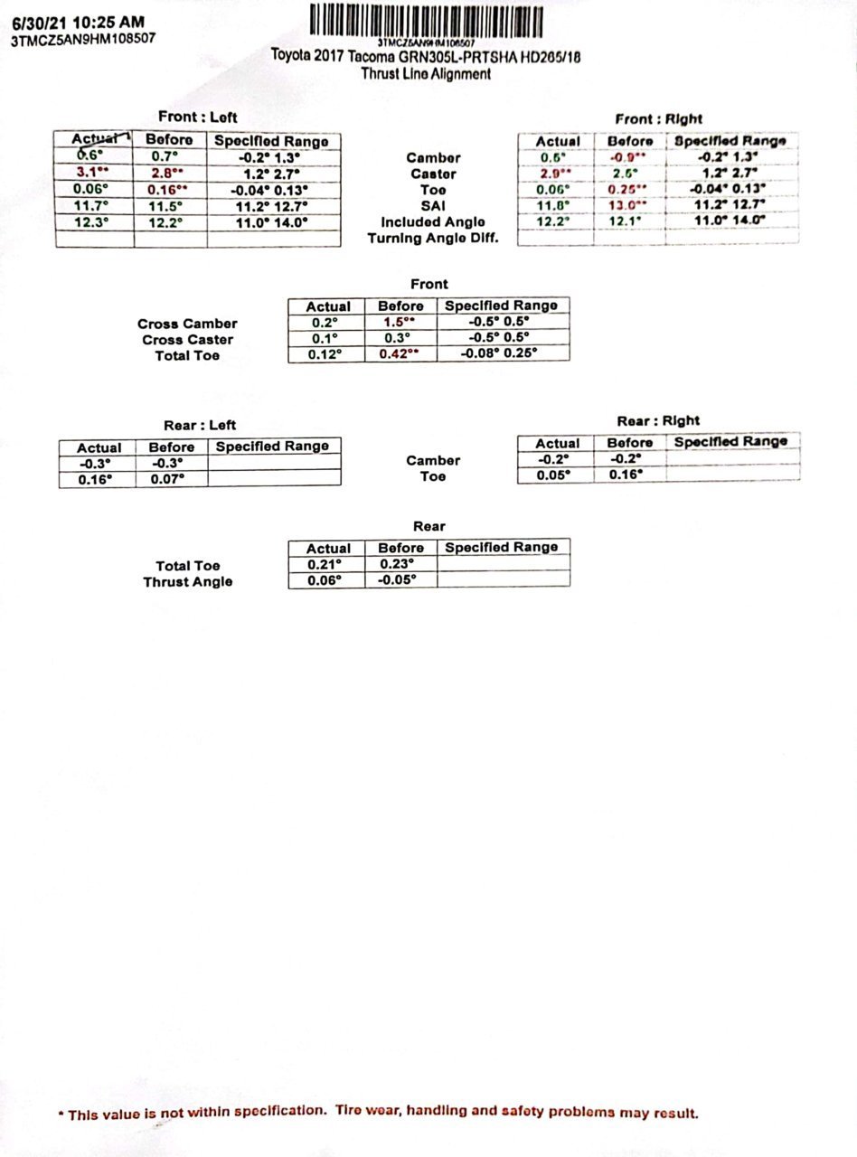

    You don't want it aligned to Toyota's spec.
    OME provided alignment numbers to use in the instructions.
    Here is how I do mine while running 285/75's, but I did a cmc and hammered the pinch seam and adjusted caster to avoid rubbingCamScanner 07-13-2021 20.10.jpg .

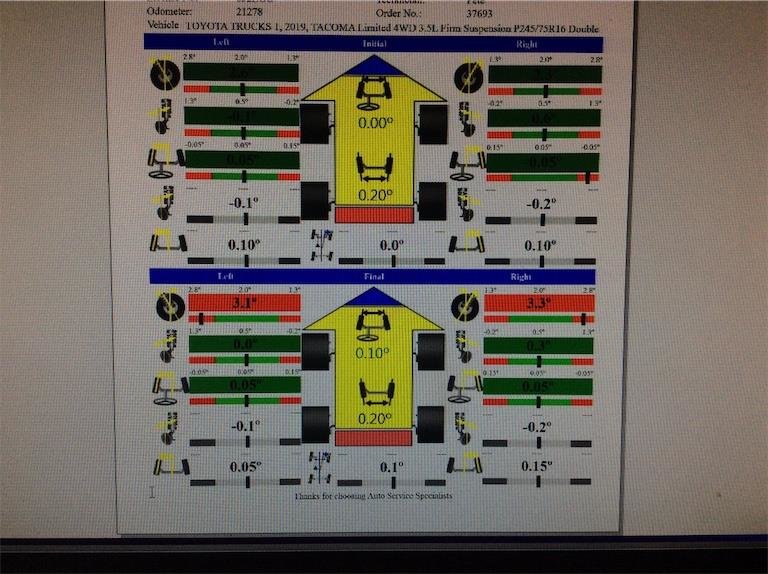

    You shouldn’t need any lubrication on the bushings, just grease in the ball joints. Here’s my alignment specs, you definitely need that 3 to 3.5 degrees of caster to get your tires forward in the wheel well. I guess it’s between you and the shop, but I would be going back and making sure they get it corrected since they didn’t do what you asked them to do.

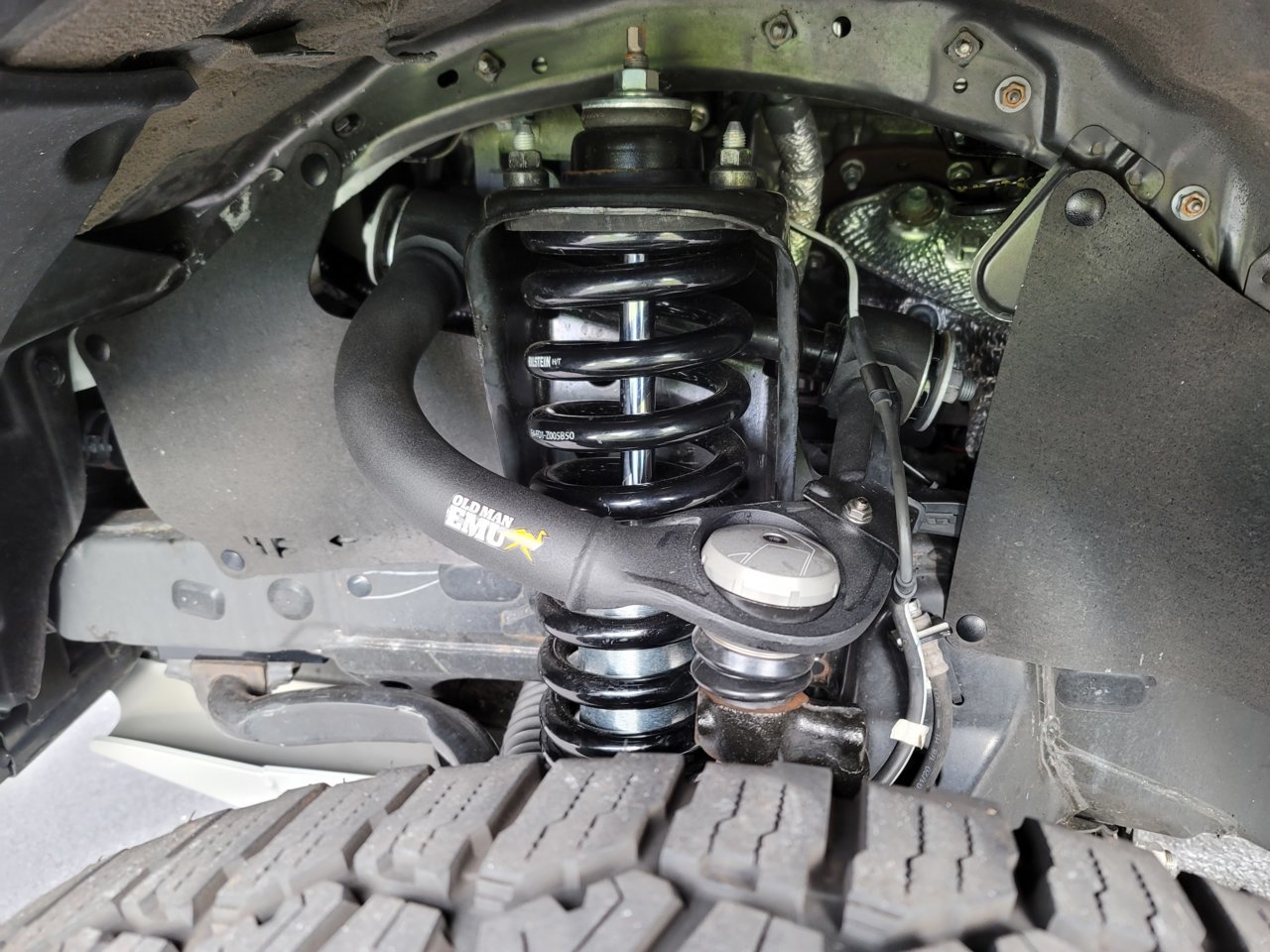

    I was told by the shop that did my install that the bushings were popping and that ARB acknowledged sending out the wrong size with some kits.
    It might be worth checking with ARB whether your kit is affected by the issue.

    Did they install washers on the inside of each joint? I can’t tell from your pic. I don’t have washers on the inside. I called arb and they said they follow factory procedures and that they should use the same amount of washers.
