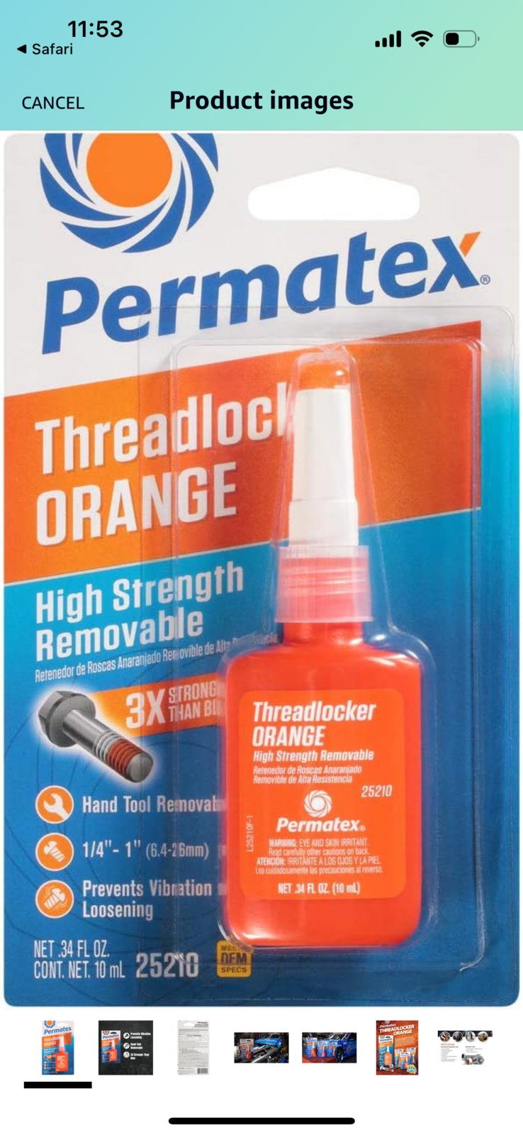

    Orange Loctite? Is that new? Purple, blue, red and green are most common.

    Didn’t know it existed until I went into ace today looking for some blue loctite!
