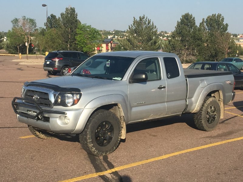

    Sorry for the really repetitive nature of this post. I know there are probably hundreds (and I've read many of them) of threads on which 3" lift to buy, but I'd like to get a little personal input before I jump in and purchase my own. That said, I'll be lifting my 2006 Tacoma Access Cab (pictured below) and wanted to know what you guys like the most; the OME or Bilstein 5100 lift. (Pics would be nice if you have them) I'm leaning the OME direction right now based on what I've seen/heard so far, but would really appreciate your input.
    A couple side questions: will I need longer brake hoses and/or new UCA's? Front diff drop or not? And will I have to do a lot of cutting to fit 285/75's? Thanks in advance guys!

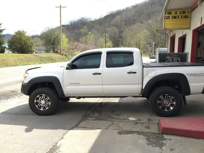

    Never have been in one with an OME lift, but i went with the bilstein. I am very happy with it. Tightened up the truck and rides mmuucchh smoother in my opinion. So much smoother that my wife likes to take the tacoma places instead of her rogue.
    Heres a pic after the lift. Its the only one i have right now. Plan on taking some more sometime soon though. image.jpg

    Thanks for the input! And it certainly looks sweet too. Are you running 265's?

    Yea. 265/75/16. Im seriously thing about going to an 20 next year though, i dont wheel my truck any (have a rzr xp for that) so im thinking of going 18's or 20's.
    No rubbing at all on my 16's right now. The wheel is a 4.5 backspacing 16x8 with 0mm offset. Just in case you were wondering.
