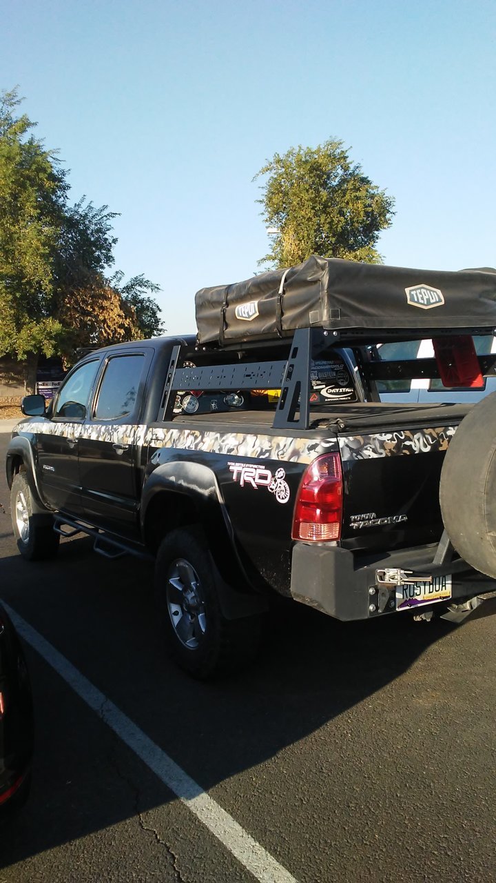

    I have a Victory 4x4 bedrack, Tepui Ayers RTT, and a Body Armor 4x4 off road bumper with swing out tire carrier that all totals around 350 lbs (plus the tire weight) with nothing else in the bed. I've seen some of the springs listed are only rated to 300 lbs so they may not be enough. Am I interpreting this correctly? I've never researched leaf springs before so this is all a huge learning curve for me.

    What I listed above is pretty much my constant weight. Add ice chests luggage etc when I go on weekend or longer trips. Its my daily driver. I'm not a rock crawler or extreme offroader (2wd Prerunner here) but I do go on Forest Roads, desert roads and wide trails, and cross a few washes here and there.

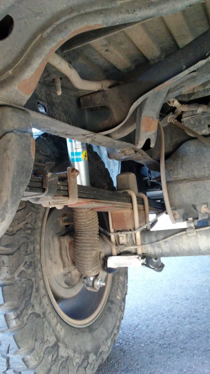

    Here is a photo of my truck and also my present leaf situation.

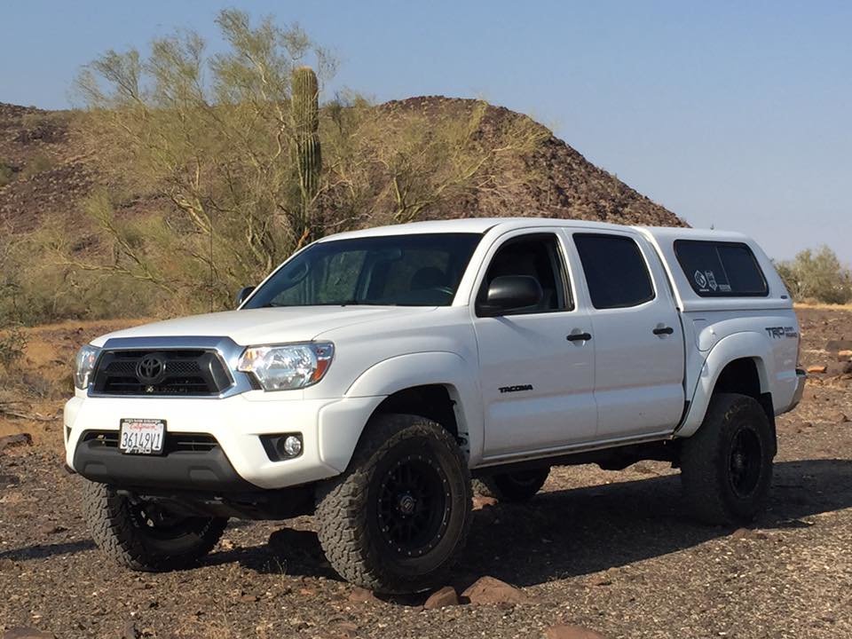

    Anyone have experience with the All Pro Expedition leafs ?
  15. Oct 14, 2020 at 1:12 PM
    FJ to Taco
    FJ to Taco Well-Known Member
    Mar 10, 2015
    #150578
    556
    Tony
    Lacey, Wa
    2015 DCSB 4x4 TRD Off Road,Snugtop Rebel
    Bilstein 5100's all around, OME 885's and OME Dakar CS047R Leaf Packs. Snugtop Rebel, pet screens,front slider drop down window. WeatherTech mats. Interior LEDS
    Biker Dave from AZ... Rosy Boa plates.... This is Tony Lanzi So Cal Herper.
    I first had Dakar AAl's on my Taco with my shell. With gear and the shell it sagged and when OR it was wishy washy in AZ when finding those Harq Boas lol!
    I did see your truck and with that weight I'd put full leaf packs on your rig. It will support the weight and it will ride so much better over the rocks. :) I speak from experience in the AZ dez lol!
    Mine are OME Medium springs and I also have 5100's, I do not have any experience with All Pro though.
    Marie @ Headstrong Offroad has great prices https://www.headstrongoffroad.com/
    bkrdave36[QUOTED][OP] likes this.
