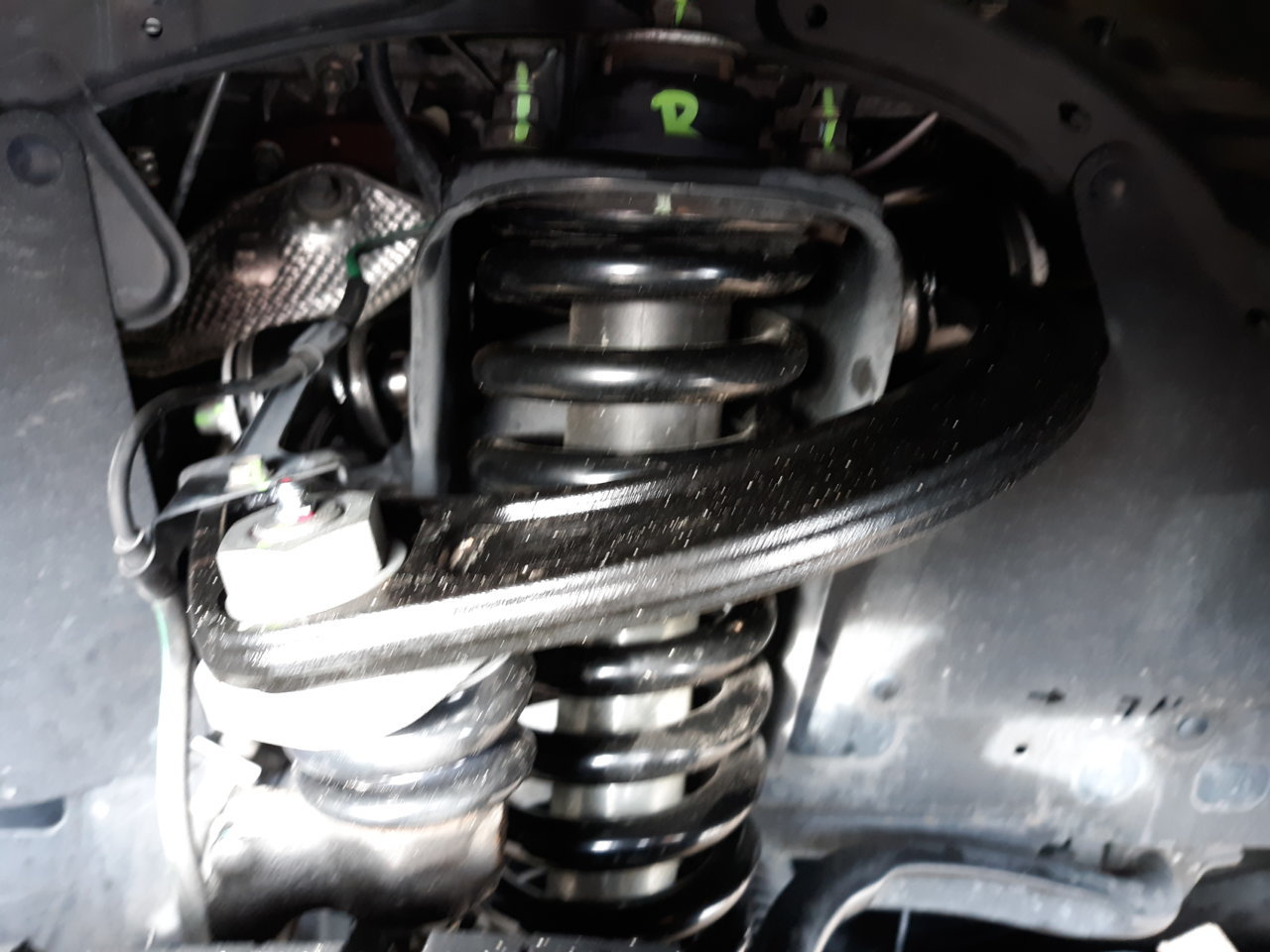

    885s just under 2 inches
    I changed springs and UCAs to add a little more height and have more alignment options.
    Both sets ride extremely well, smooth without nose diving under braking, absorbs bumps while recovering quickly. It's a soft ride with firm control if that makes sense.

    Which UCAs did you go with?

    SPC (Light Racing) UCAs. They seem to have the most adjustability for the cost.
    I got them on Amazon last month for $460, looks like they've bumped up the price since then to be more in line with vendors like Headstrong and Wheelers.
    I was considering JBA but I couldn't get over the bright red color.
