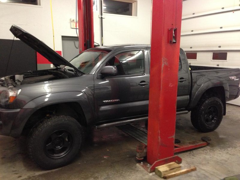

    Before Lift

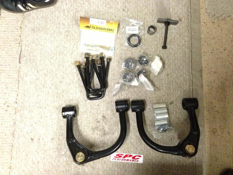

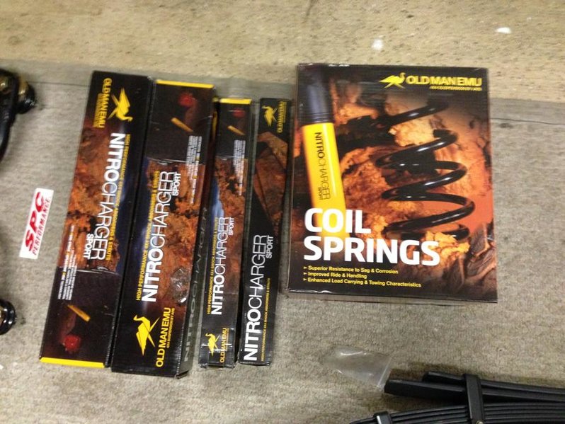

    All the Parts
    ECGS removal tool and Bushing
    SPC UCA's
    Carrier Bearing Drop Kit
    OEM Bushings for Dakar Leaf springs
    New U-Bolts for Dakar Leaf springs
    The shocks and springs

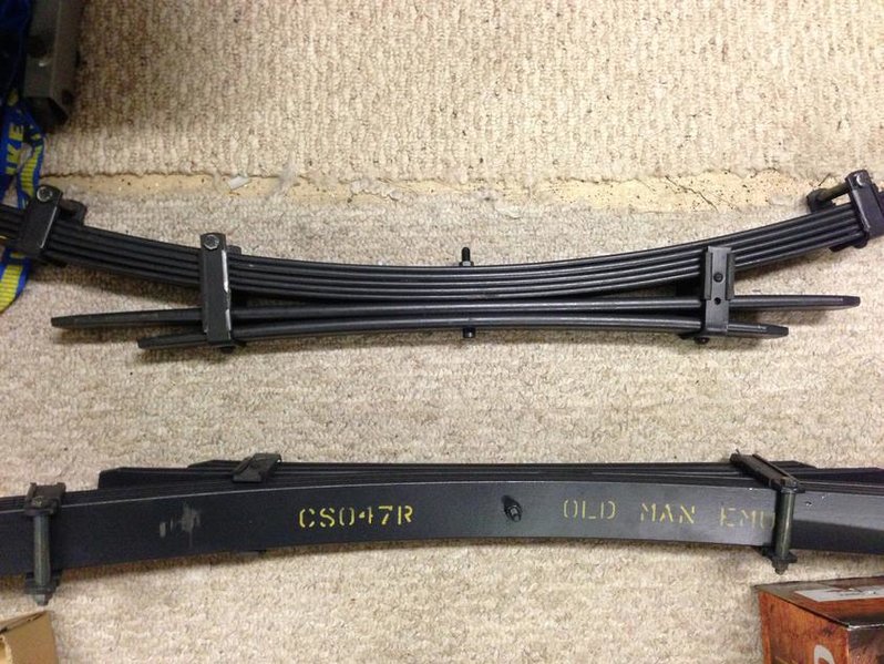

    The Dakar Leaf's

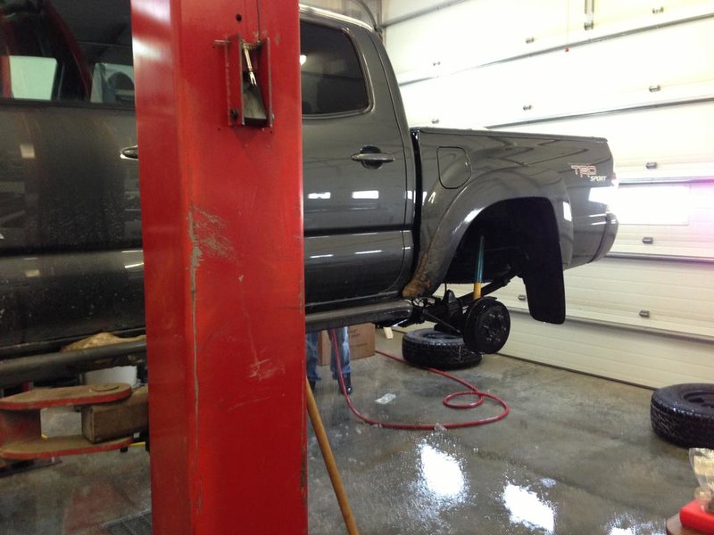

    Up it goes

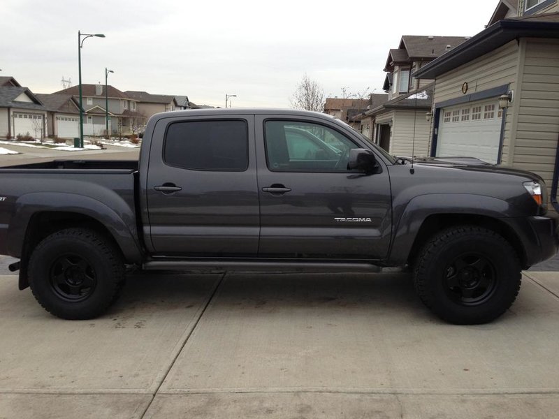

    After 12 hours mostly working solo

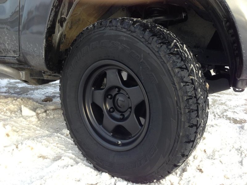

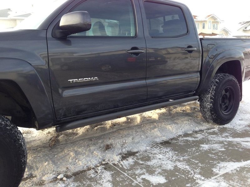

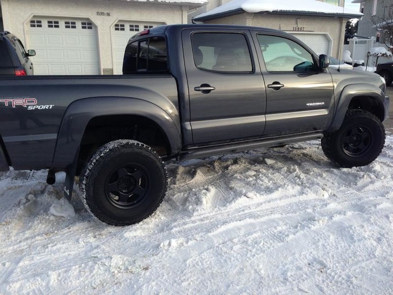

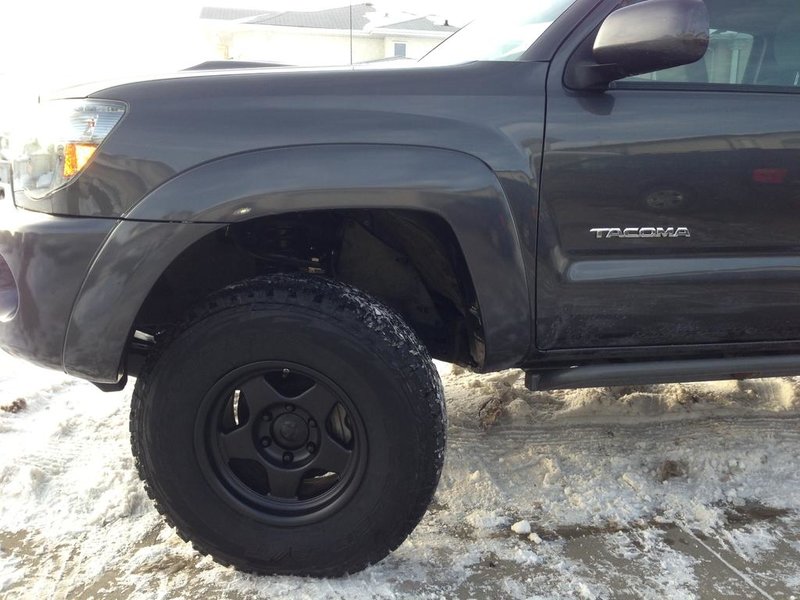

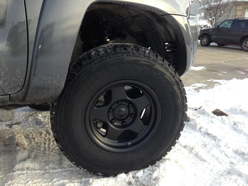

    - Weather Tech floor mats - 16" SCS F5 Matte Black - Bridgestone Dueller AT Revo 2 (265/75/R16) - OME 885 COILS - OME FK29 DriveShaft SPACER - OME 90000 NitroCharger Sport front struts - OME 60091 Nitrocharger Sport REAR SHOCKS - OME DAKAR CS047R REAR LEAFS - SPC Light Racing UCA - ECGS needle bearing replacement -SHROCK WORKS Sliders
    Here are a few pics with the lift and wheels, I must say that going from the factory 17" down to a 16" wheel improved the ride.
