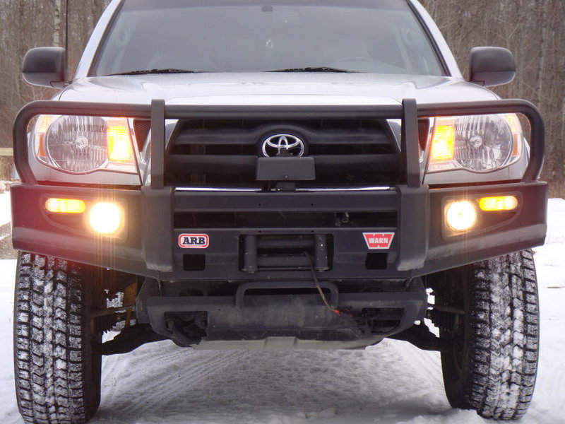

    i'm on here searching if i can fit those tires, and what kind, on my truck, with the ome set up, on stock trd rims.
    i will let you know what i find, or hopefully someone can offer some insight.
    cheers

    Cool, thanks for the info, i kinda knew that, having read so much great info on here. I have the same ome set up, with the .25' top spacer.
    Running a great set of cooper 275's winter studded now, looking to replace the summer bfg's, but they seemed too stiff, type E.
    The cooper st 255/85/16 is probably the way i will go also.
