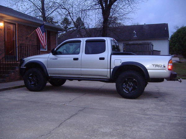

    here is a before and after......................there IS a difference................and the ride is great now.
    before
    after
    if i could do it all over again.................i woulda gotten new eye bolts. the shackles are fine....longer u-bolts are needed, and no need for the flip kit.

    cool. doesn't look like much, but looks good.
    Alright I'll remember that.

    yeah......it wasnt much. i wasnt really looking to lift the truck anyway..........stock suspension was shot, so i needed to replace. so i decided to go with a bit of a lift over stock. suits my needs just fine.

    hey man.....here is some of my most recent pics......
    dirty.......
    and clean........
    and here is all of the stuff i bought when i did my suspension...and the pic is minus the bilstein 5100's.......
    what i got......wheelers 5 pack rear leafs(made by alcan spring company), extended u-bolts from wheelers,ome 881 coils, goodridge g-stop braided stainless extended brake lines..all from wheelers, and a bushing kit from energy suspension...because it came with the upper rear spring mount/frame bushings................just to note...the leaf springs i got from wheelers have the good polyurethane bushings already in them. and to add.....get new eye bolts from wheelers.......i wish i had done that. had to cut my damn springs off. and lastly.....bilstein 5100's from downsouth motorsports(a vendor here now).
    hope this helps ya out man!:)
