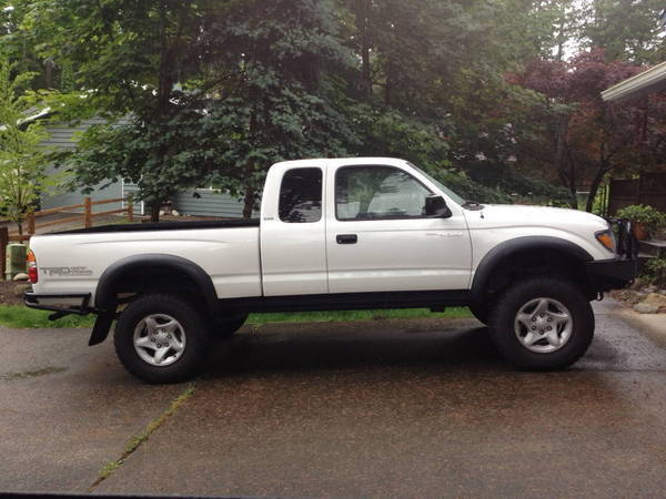

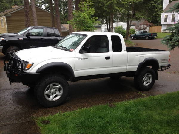

    Thanks for asking, yes I did. I also had an ARB with a Warn M8000 on the front and a demello rear bumper. After about 2 years I had no significant settling and the truck was able to be aligned just fine without upper control arm replacement.

    If by front you mean which springs did I choose then I went with 882's due to the bar and winch. If you're only going with a ARB Bar and no winch then I'd recommend the 881 coil springs.

    I was local to ARB's U.S HQ so I didn't pay shipping and I paid about $900 for it. I did a diff drop as well as a carrier bearing drop and actually had more of a vibration with both of those post lift than I did after I removed them. All in all I never measured any of the angles on the DS or front axles v=but in 2 years of having the lift I never tore a CV boot or had to replace a u-joint.
