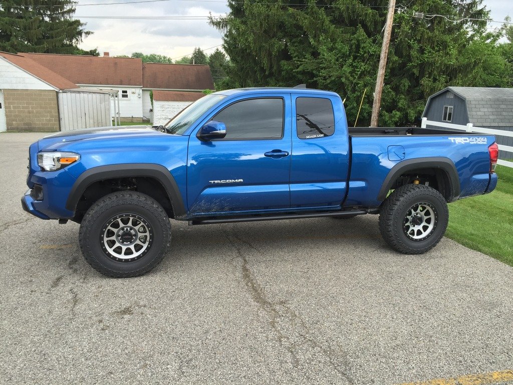

    the have the original nitrochargers, not either of the sports. rides better than stock, even with 10 ply 33's

    I'm still slightly raked, with the rear being higher. 885's would be really bad, I think.

    @Aussiek2000 You running aftermarket uppers? If so which and how are you liking them?
    I was probably going to go with the 888's and the Dakars with the 3rd leaf removed. I'm sure I'll be raked as they are stated to have a lift of 50mm's front and back, but I honestly would rather to be raked with a suspension lift than try to level out with spacers. You using your trim pack spacer for lean?

    trim packer on LF. I have light racing upper arms, they are great. Probably never would have got it aligned without them
