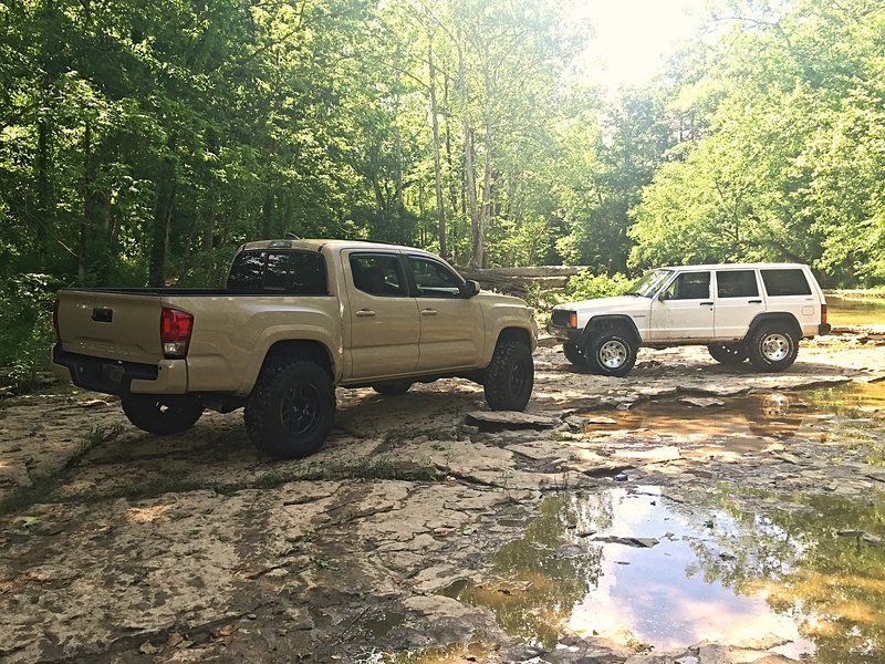

    2016 Quicksand Tacoma TRD Sport

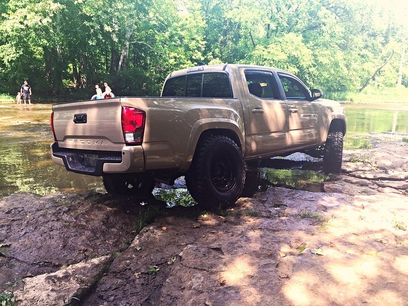

    OME Suspension Lift Deaver AAL Mickey Thompson ATZ P3 285/70r17 SCS Stealth 6 17x8.5 Spidertrax 1.25" Spacers LED interior lights Hella Supertone Horns
    17x8.5 -10 offset, and I'm running spydertrax spacers. chopped cab mount and trimmed front fenders flare.

    Thank you!

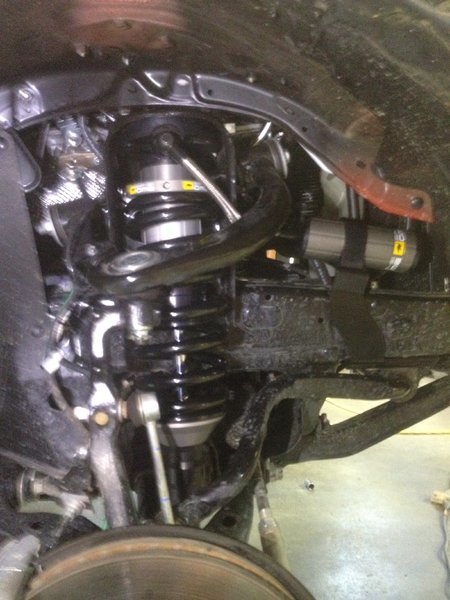

    I just installed the ome bp-51 kit with the dakars and at full droop it was stretching on the brake lines pretty bad. I bent down the top brake line mount and bent the bottom mount up and all is good. A spacer could also work but it was very simple to bend the mounts.
    So far I am very impressed with the bp-51s! I have had ome old stuff on my 02 double cab and my 100 series landcruiser and they were ok but lacked the dampening on the rebound, this is why you end up with the harsh unloading over speed bumps,
    the new stuff rides better than stock on the street and offroad they are amazing!
    I know they cost about 2k more but if budget is not an issue I highly recommend bumping up to the bp-51s!
    I am very picky when it comes to my vehicles and I will say this is the first thing I have ever bought that has exceeded my expectations, only time will tell how they hold up. image.jpgimage.jpg

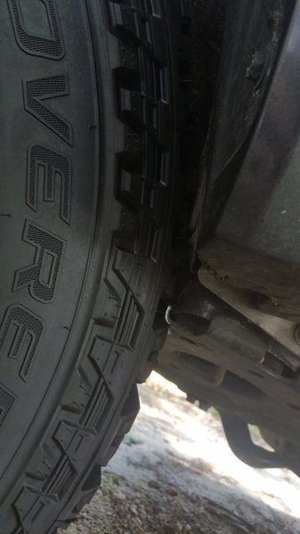

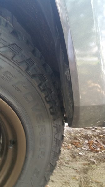

    Finally installed ome 888 w dakar. I have some bad rub at full turn on to bottom corner of wheel well frame. Any ideas what to do. Do I have to trim the frame?
