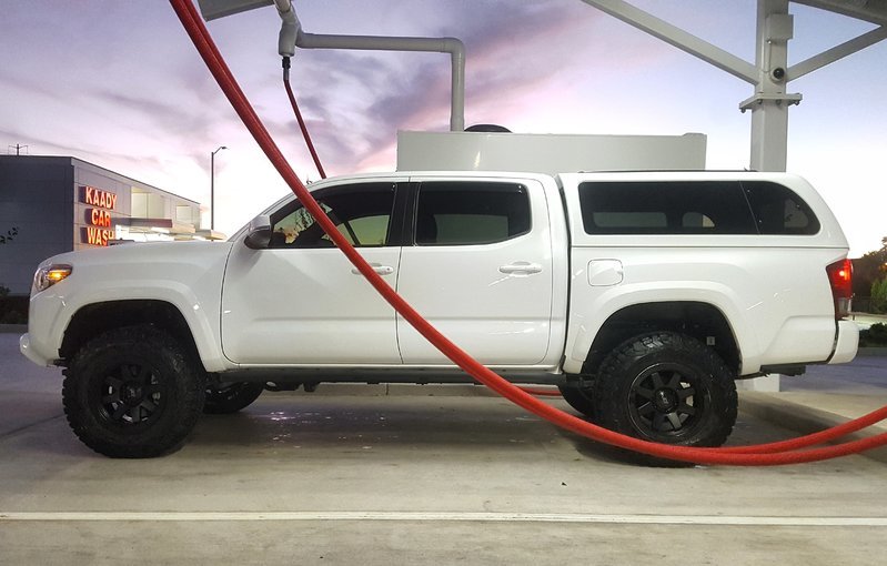

    Nope...worked out fine no rubbing...

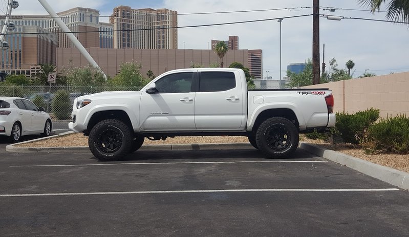

    Lucky! Same set up except I'm rubbing on cab mount I didn't put the 1/4 spacers in maybe i should

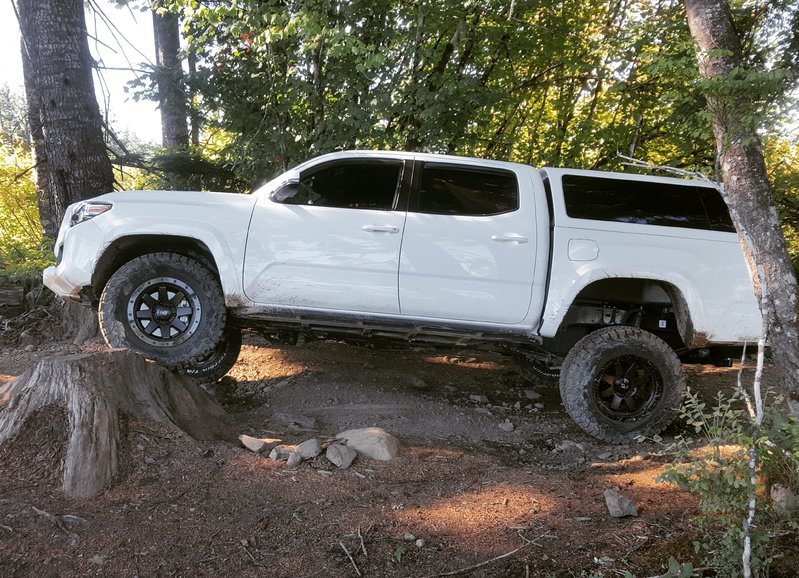

    You can get away without changing the brake lines if you don't wheel it. A lot of people who installed their Dakar said at full droop the brake lines were really tight. To me it's better to be safe than sorry. On my pix where my truck is flexing I'm sure my stock lines would've have ripped apart but if you're just driving it normally then it may be OK. I didn't take any overload leaf off so IDK what to tell you on that part. My kit is the exact same kit as the Headstrong 887 kit with Dakar leafs...
