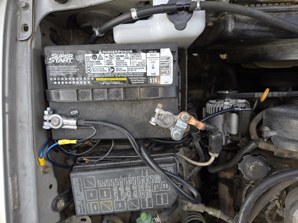

    Can you post a pic of the top of your battery showing the cable terminal ends??

    Thanks for the pic.. On the blue chassis ground, the bolt looks rusted, how are the threads and the female threads as well as use a little sand paper and clean to bare metal at the bolt eyelet terminal, use some dielectric grease on it as well at the but connectors to prevent future corrosion... On the cable to the alt bracket, it looks a little grungy (from the pic anyway), clean that area as well as the threads going into the block/head, you need clean metal on metal, as well as make sure the alt pivot (through) bolt has clean threads as well as the bracket were the alt touches...
    Basically, make sure ALL grounding areas are very clean where metal touches metal...
    On the pos battery terminal, make sure it is all the way down the battery terminal post (like it is on the neg post), also make sure both terminals are tight enough that you can not twist them by hand... same with the wires going to it...

    The battery says 7/24, should still be good, but have you considered the battery may not be taking full voltage? I'd put it on a float charger overnight, see if it will take 13+ volts. That particular one has a three year warranty so if you keep receipts or paid with a debit/credit card and it's not taking full voltage it can be replaced.
