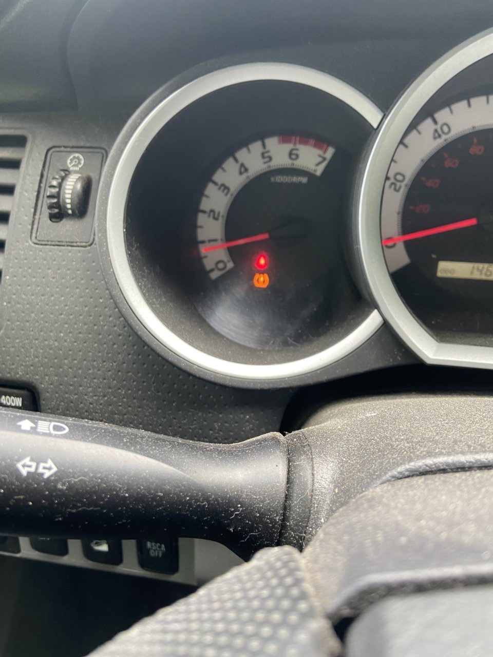

    Not the engine light, the maintenance required light is flashing. Only on start up, then it quits.
    Just did the oil change with filter about 4600 miles ago, including U-joint lube.
    Glad I have a long weekend coming on, I hate to spend time running through diagnostics, parts and repair. I was hoping to have a beer laden weekend.
    Any thoughts to the problem???

    It means it's time to change your oil in about 400 miles when you hit 5000 miles... that is all

    According to my dealer, the reminder comes on every 5000 miles so you bring it in for their 120 point checklist. The oil needs to be don e every other time.(10,000 miles) I was just there yesterday and asked that specific question. Under his breath he told me the salesmen don’t even give out the right info. I change mine every 5000 so I dont care but I was curious.

    just reset the light if you don't need to do any maintenance

    Just put the OD on trip A, hold the button, and turn the key to the on position. You’ll see 6 zeros begin to go across the OD. The light will be reset now.
