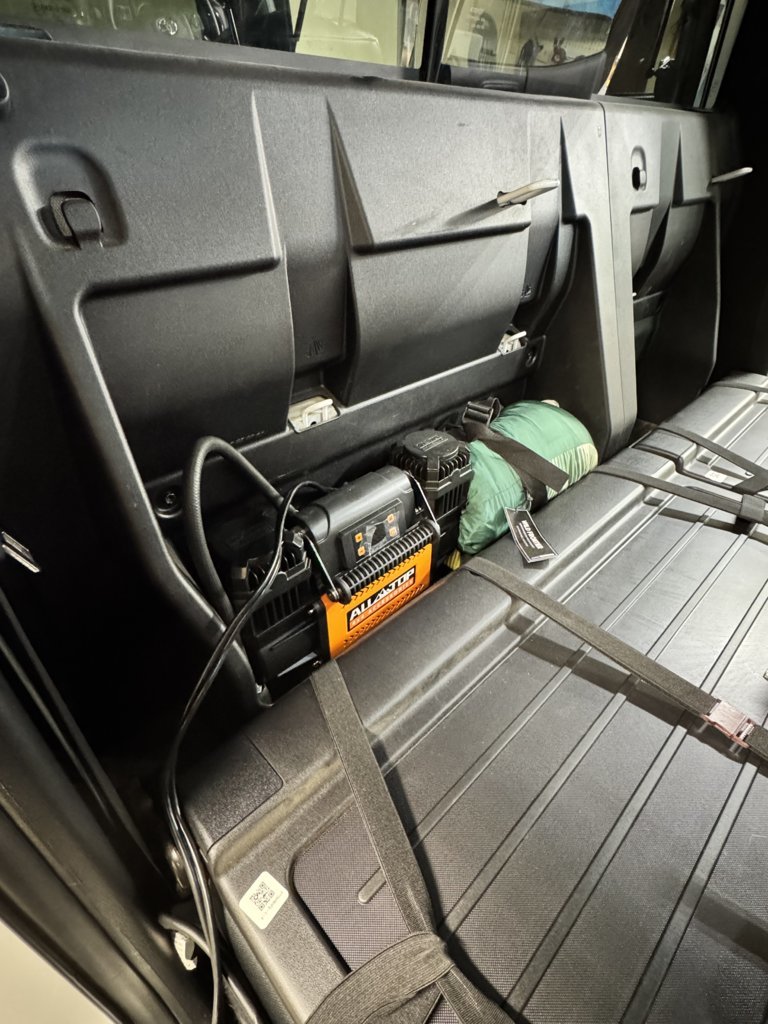

    Was messing around cleaning the truck yesterday and noticed my All Top compressor fits perfectly behind the seat. Got me thinking, I'll try to spell this out to make sense.
    1. Cut off alligator clips, install warn winch plug (Male) to compressor + & -
    2. Run wires from battery to bed of truck and install female end plug with battery disconnect as added safety.
    3. Install another female plug to alligator clips to still be used as a mobile unit if needed.
    Basically, then you can run the power cord to bed of truck from back seat when needed and power the compressor. ALSO, if you need to take the compressor somewhere, you still have the alligator clips to use on another vehicle. Basically a two for one? Or am I in dreamland. Popping my hood is getting old and I'm just being Bougey.
    Don't have lockers or anything so I totally understand the ARB setup and cheaper options would do the exact same thing, just trying to think outside the box for the current setup I have and not have to break the bank for a little tire air!
    Anyone made something similar?

    Gonna be hot in there. When I’m traveling my back seat is usually full so emptying it just to run the pump ain’t happening.
