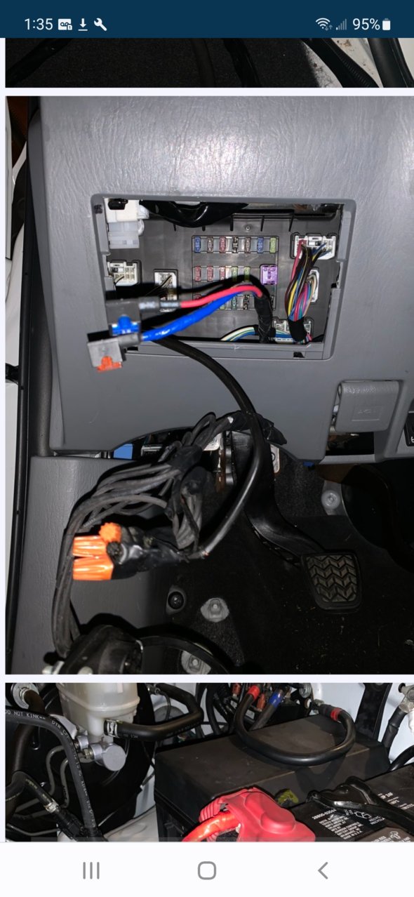

    Bro…. the wire nuts and electrical tape have nothing to do with the final wiring. They were merely temporary connections while I moved other things and tested function.

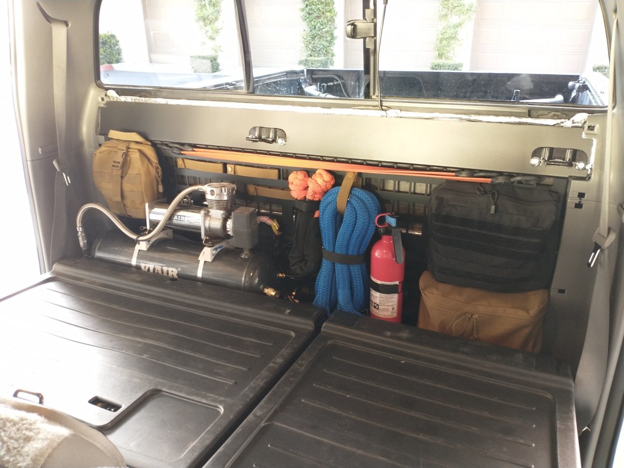

    Viar 300 P for up to 33" tires. I prefer the "Grab -N-Go" factor of the portable ones, as I can use it for any other of my vehicles I may be driving at the time.

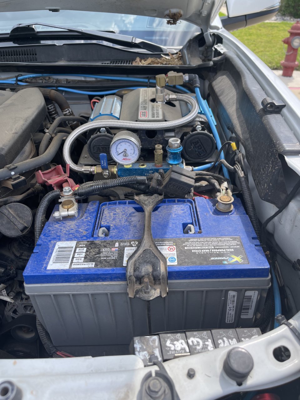

    For only lockers a small viair will do the job but why not get something that will fill tires quick too?
    I did the 100% duty cycle viair with a tank at 180psi and with 33” I can take 2 tires from 20psi to 35psi in under 2 minutes.
    If I could do it over I’d go with the ARB twin compressor though. It would have saved more space but at the time I didn’t want to spend the extra $$.

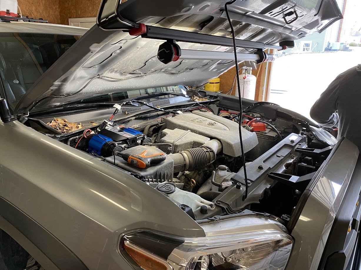

    I just ordered the M.O.R.E twin arb, 1lb tank, and mount (based on extreme terrains assessment of vehicle fitment) ... but... the abs unit sits where the tank needs to mount.. is the ABS module located somewhere else on the offroad, or does your mount stand over it? (My break module is over the passenger fender behind the air box)

    My mount goes above the ABS module.
