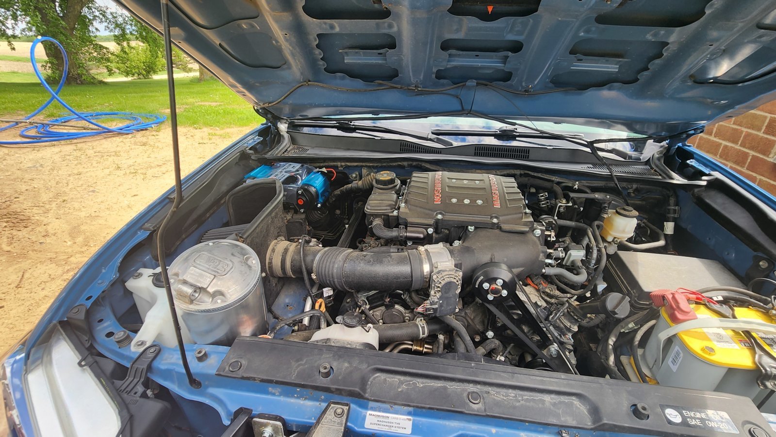

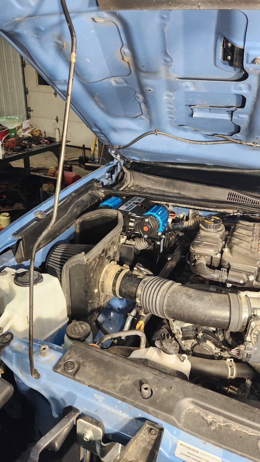

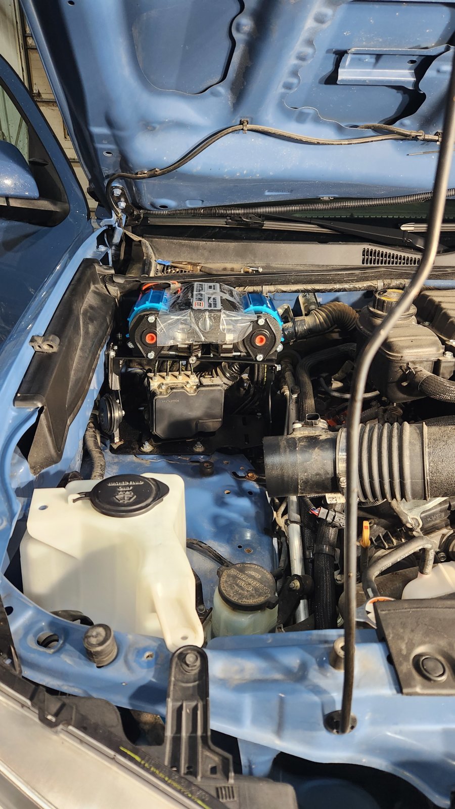

    Worked out with the M.O.R.E. mount.. had to flatten out the factory abs bracket and re-bend in new locations, re-route the abs wiring (easy), and slightly adjust the bend of the brake lines coming out of the top of the module. Simple bracket to make for the tank, single bracket to make for the power steering res. Which will mount to the outside of my k&n box.

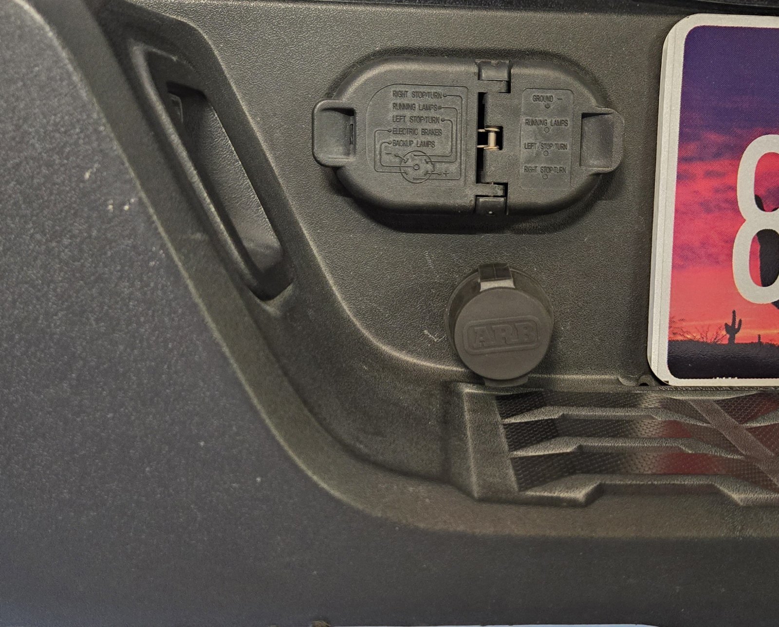

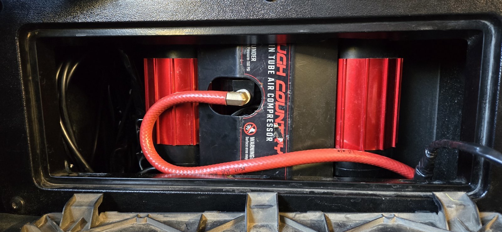

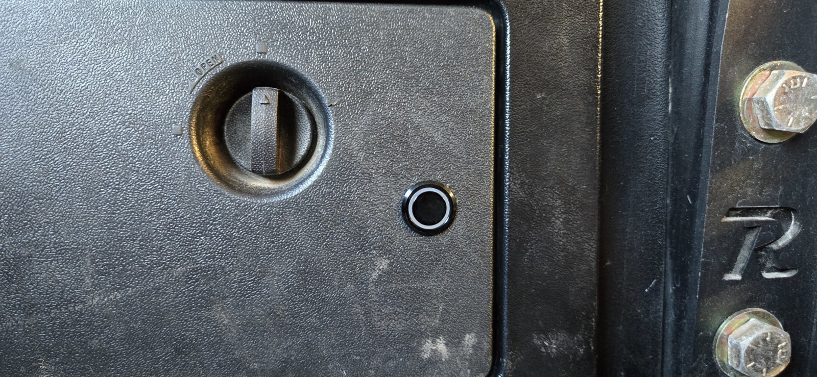

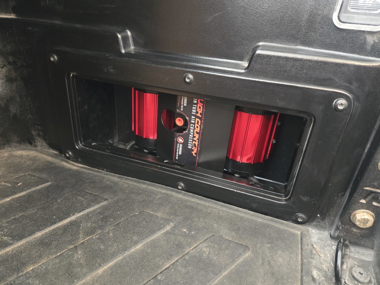

    I had a Smitybuilt portable compressor. Ended up installing a Rough Country compressor instead. Mounted in the truck bed cubby.
    Ran the line out to a coupler on the rear bumper.

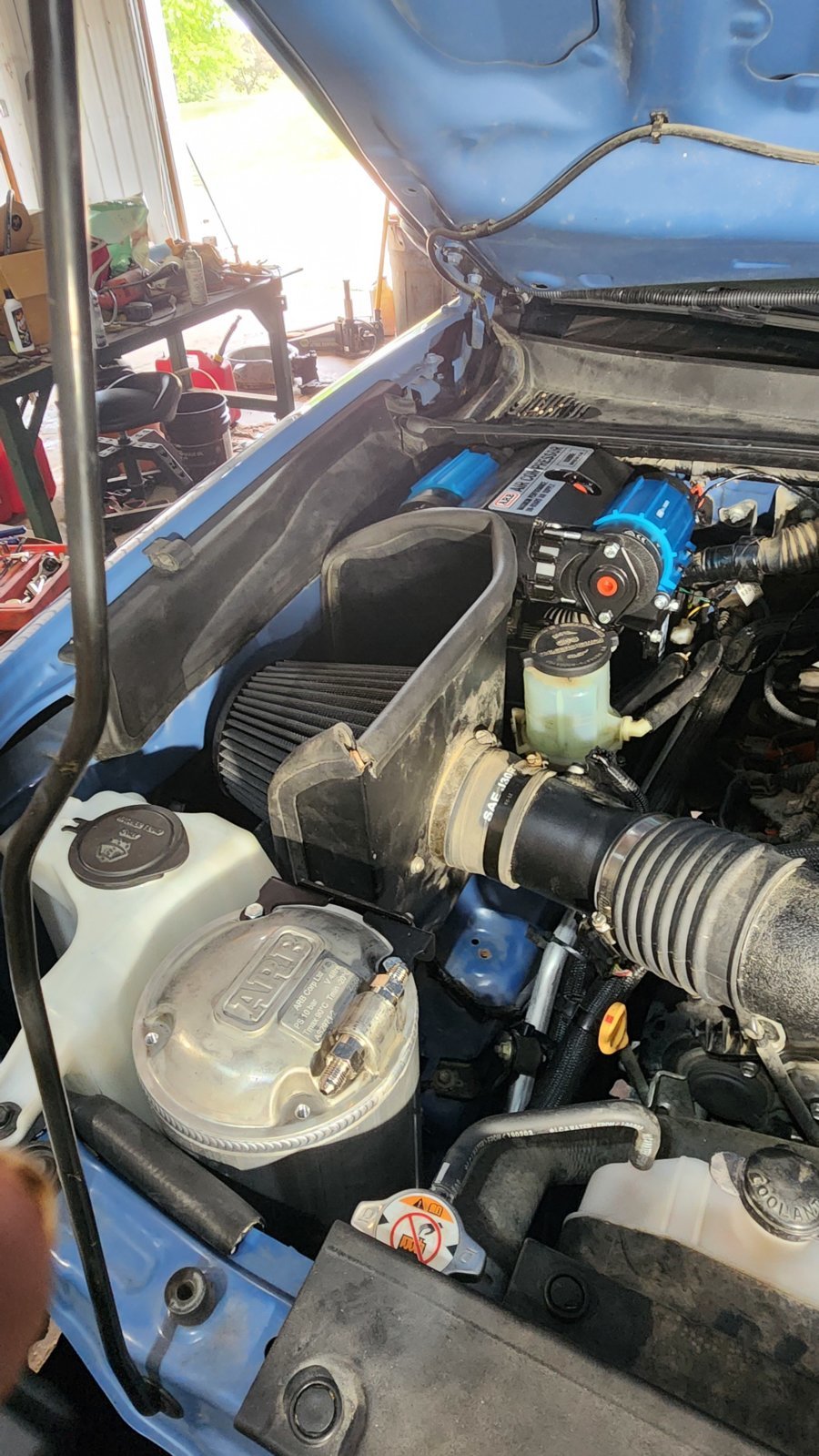

    It's in there. Just need to run airlines from compressor to tank20240602_144659.jpg
