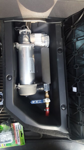

    Viair 450, It was a carry around but I mounted it under the rear passenger seat. 2.5 gallon tank, 2 wires, 1 air line, very simple. Compressor has built in Thermal and Psi. so no extra wiring.

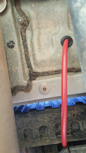

    Through the rubber grommet in the middle of the cab at the back.I'm going to do hard line as soon as I get the things and time.

    I was going to use some stainless tubing I had at work but i can do 3/8 copper gas line for about 20 bucks. One swagelok fitting was going to cost more than that.

    any issues with the heat from the compressor melting the plastic? that'd be my only concern, just order the same compressor and toking for a place to mount it.

    I had the same concern but l topped off and purged the tank 4 times and no problems with heat or the thermal switch. Takes about 3 minutes from empty. I've been trying to see what it will take and so far no problems. I will redo the tubing to 3/8 dot brake line when I get time.

    I went with this area because I wanted to keep it clean, and with everything closed it will still does not get hot enough to hurt anything. It's not too loud to bother anyone but it does make the seat buzz. Outside the truck you can barley hear it. If you really had to work it I would leave the compartment open but I've ran it pretty hard and had zero issues. 8 gauge 12v, ground under seat bolt, plumb and mount tank, done. Get your kids to help so you can smile evrtime you see that crooked tank under there. :)

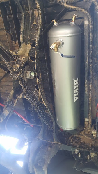

    Where is the tank? I cannot tell

    Back of the bed behind bumper

    Do you have the tow package?

    Yes, and a spare tire fore sale now because that's not going back in.
