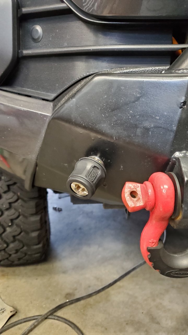

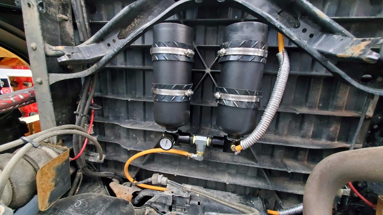

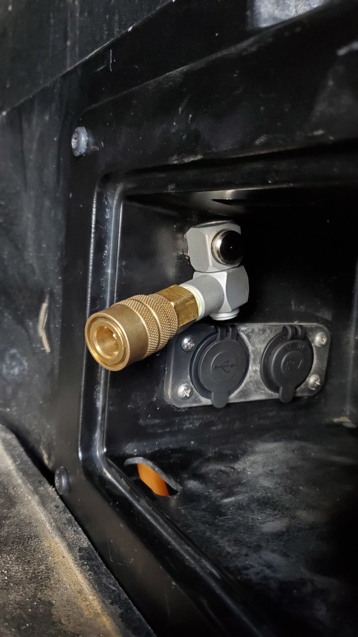

    Just complete this project this past week. Mounted the compressor under the hood, wired into my switchpro. One connection on the front bumper and the other in rear bed. Also mounted two tanks under the bed. Going to be building a bluetooth solenoid controller for airbags, which will attach where gauge currently is.20200328_163904.jpg20200404_174817.jpg

    Love how you mounted your tanks! :thumbsup:

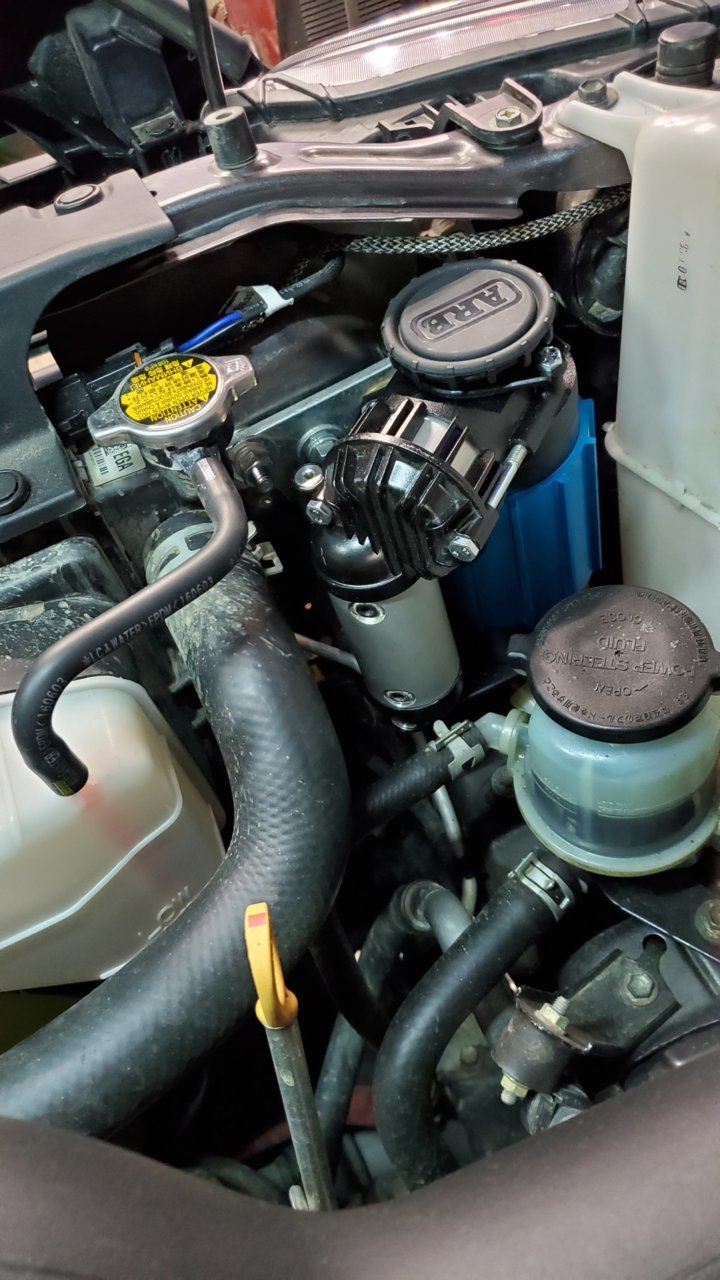

    I did the slee mount dual ARB with ARB 1 gallon tank underneath it. I like it. Fits snug in top left of engine bay. I have a manual though. I think the auto has something up there.
    I think the C02 is a way better option but you have to pack it. One more thing to have strapped to the side of your truck like your axe.

    seems like a few people have chimed in on this, but would love more info. How do you get the air from back there to outside the cab?
