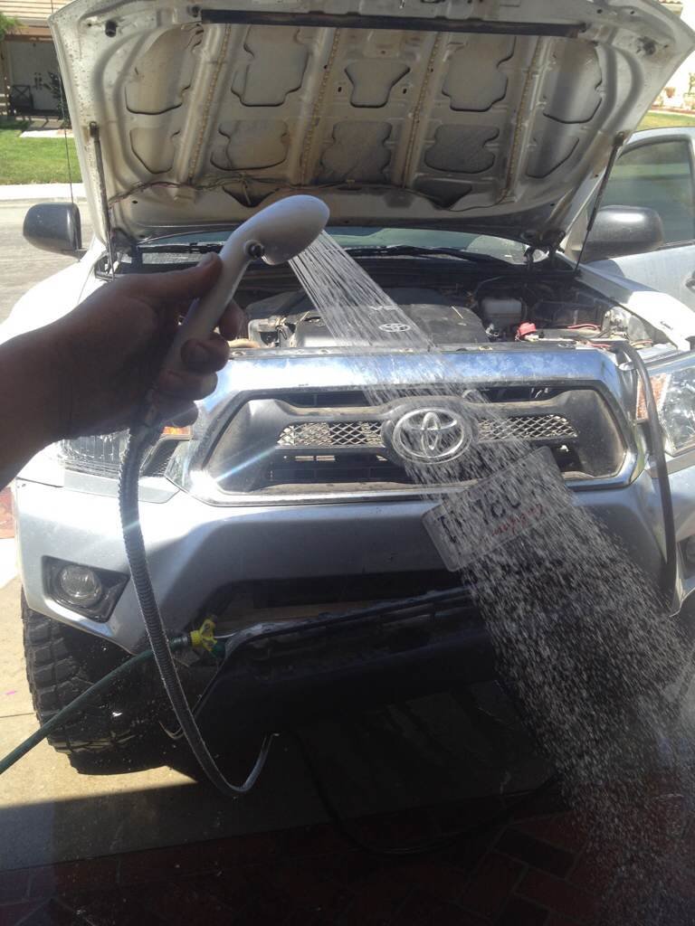

    IITTSSS ALIVE!!!!!
    I deleted the check valve in place of a regular ball valve and it now works PERFECTLY!
    I hooked up just the hot side with a hose & the water came through so hot that the thermostatic valve shut itself off.
    Tee'd in to flow hot and cold from test hose and PERFECT water temp came out of the shower head.
    I'm so damn excited. Now just to mount the pump / hoses & clean up install

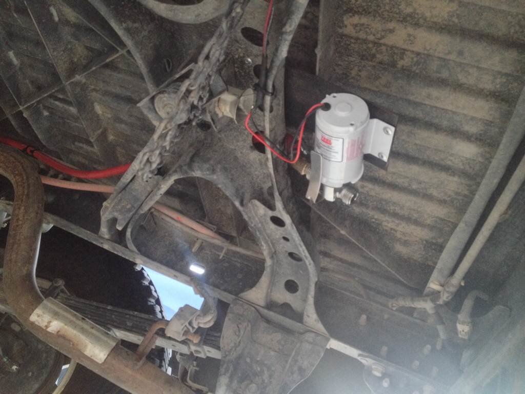

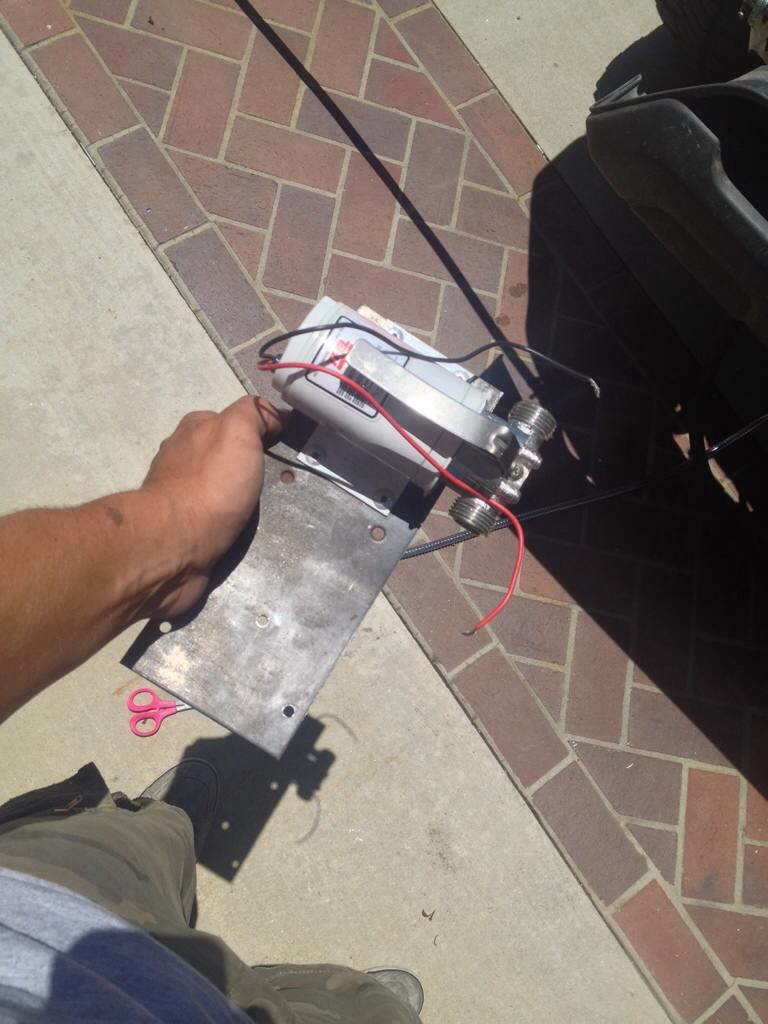

    babeze8y_c1dd4b7b0a4025b71b8636886137c7ecf0937738.jpgpump bracket
    Mounted and plumbed

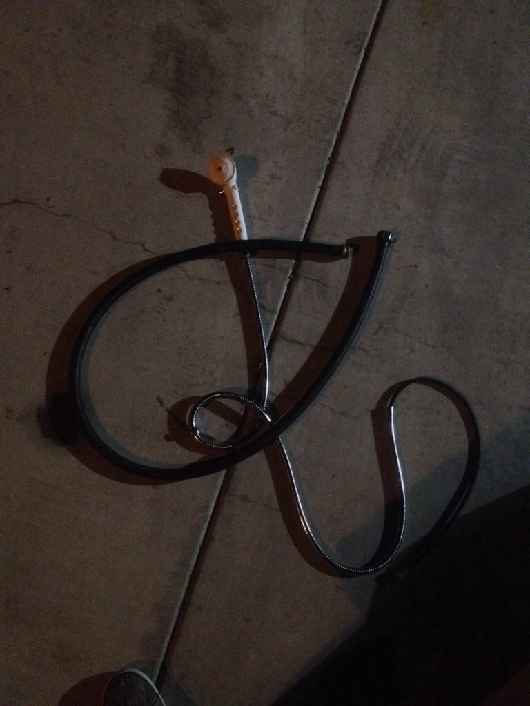

    These two items are all I need to carry now!
    RV shower head and a length of double female garden hose fittings- they stow easily in the cab and are just as easily replaced at a walmart if lost or broken.
    The shower head screws onto the mixing valve up front and the double male goes into the pump
    Throw it in a 5 gallon bucket & good to go!
    Five gallons lasts just under 10 minutes- no pressure or temp drop. Kept the engine around 180 degrees as well.
