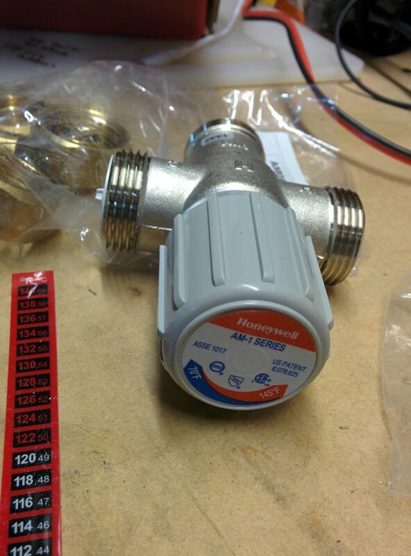

    This showed up over the weekend. Not sure how much fun it's going to be to adapt 1 inch FNTP to half inch hose barb. Time to visit the plumbing shop.

    I got my weird barbed to NPT fittings from a hydraulic hose shop. They usually have high pressure rated quality bits and pieces

    ^Thanks. I like stores like that. I'm selling the valve pictured above. I ordered the Honeywell AM100-1LF Lead Free Mixing Valve (70-145F) NTP version to replace it.

    Picky picky! What was wrong with it anyways?

    Long story short, I save no money buying mixing valve on sale with wrong fittings, and having to adapt it with adapters for the project. I did find 1" FNTP x 1/2" FNTP reducing coupler in stainless only, it's not cheap, and even worse than that is trying to adapt with brass; a lot more expensive.
    Everything in my project is 1/2" so it makes sense to just stick with that. :)
