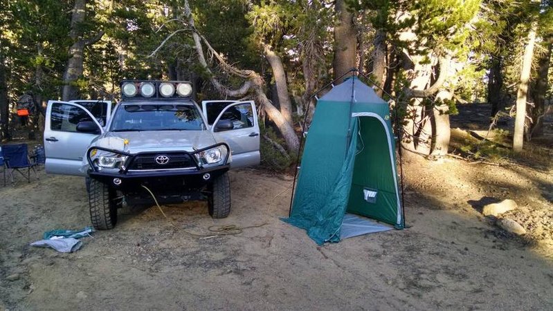

    I just spent ten days out on a hunting trip with my dad and each used the on board shower almost every day. quickly learned my stupid pump does NOT self prime and had to learn the " squeeze a water bottle underwater" trick.
    after that got worked out, I realized it's awesome to come back from the trail every day with the cooler of melted ice from the morning run and drop the intake hose there- stretched our dedicated wash water a few more days by making use of it.
    worked great even when I was pulling cooler water through that still had ice floating in it!

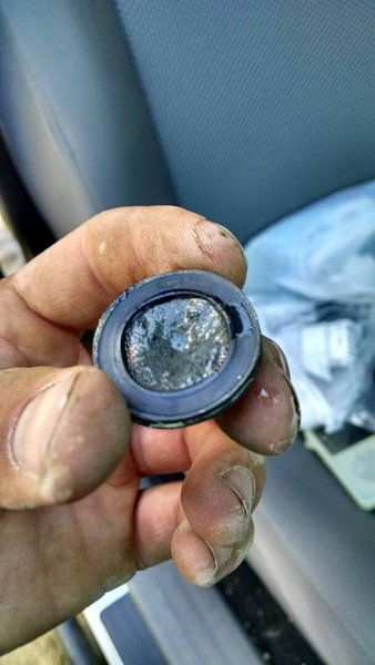

    until the fourth day when little bits of crap accumulated in the screens installed on the mixing valve and I was ass nekkid in 40 degree weather with a slow trickle of ice water pouring on my head...
    on my setup, the cold intake side of the valve is a much shorter run from the pump, and with the same resistance on both hot and cold sides, the path of least resistance is only cold water through the valve.
    Another tip- when installing your system, use LocTite pipe thread sealant or some paste type- rather than Teflon tape- I only used teflon on two connection points and little bits of it ended up on the screens- a bunch of the paste did too, but that wont create big blockages in the heat exchange, and enough hot water through will eventually push it out.

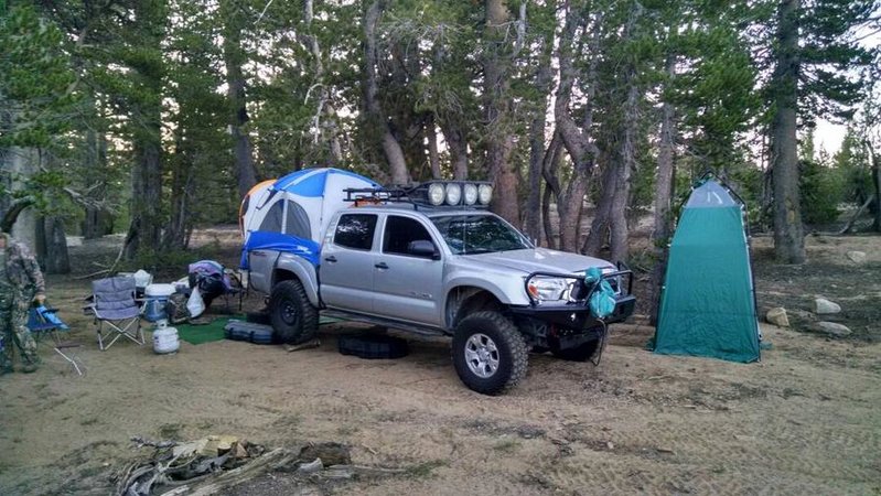

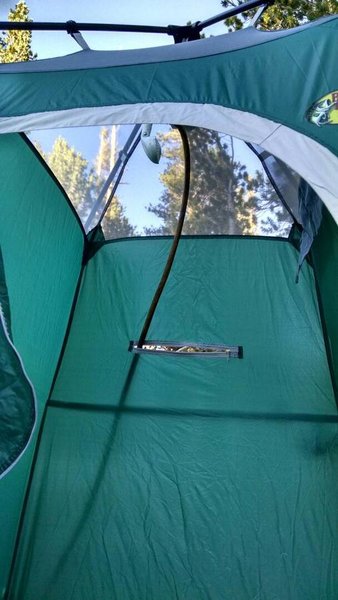

    uploadfromtaptalk1408857604917.jpg don't judge my dirty bum hands I clearly needed the shower ha
    The screens were totally clogged with bits of crap from the cooler, the fresh water line connections.
    The shower tent from bass pro shops was an awesome investment. Kept the heat in and the cold wind out.
    Using my on board air hose & hung the shower. I've got an overland hotel on wheels now uploadfromtaptalk1408857838089.jpg

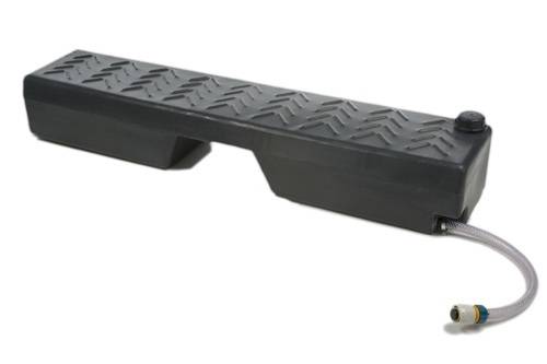

    In between the front and back seats. The only problem I see with that tank is how to do you get water from one side to the other when the level gets low?
    Is there an outlet on the other side?
  20. Aug 26, 2014 at 10:14 AM
    #240
    Bobbb
    Bobbb "Rumors of Bob, but never Bob. It is Bob, right?"
    Sep 14, 2011
    #63498
    1,244
    Bob
    Bob
    Bob
    Tundra TRD/OR
    Just lift the other end up and dump it across would be my guess. Shouldn't be too heavy.
