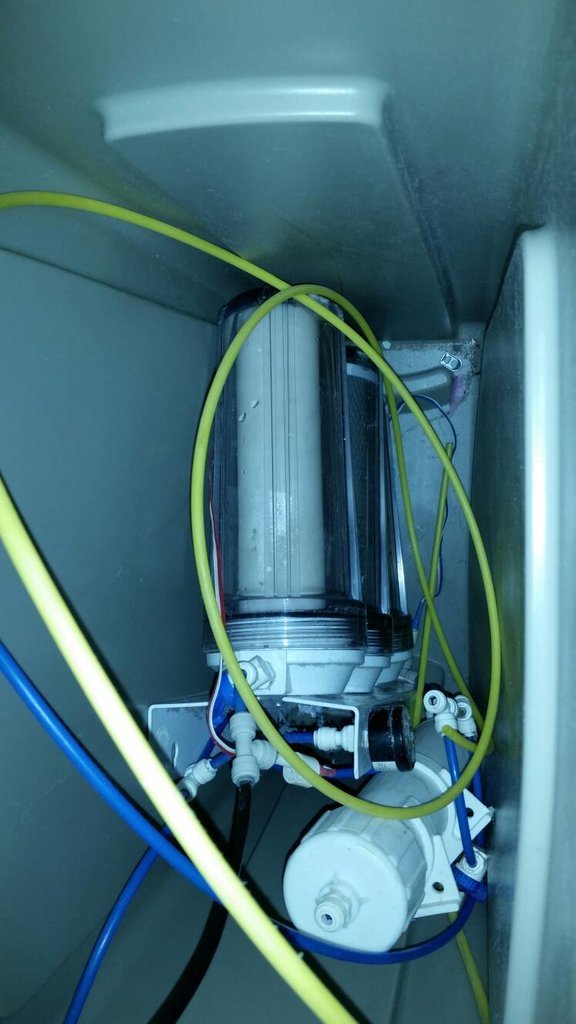

    RO/DI systems are a huge waste of water and are extremely slow. You waste 4 gallons of water to produce 1 gallon of filtered. That looks like 90GPD setup, which means in 24 hours, you will waste 270 gallons to produce 90, which is about 3.75 gallons an hour.
    Source: Used to run a salt water fish tank and mixed my own salt water out of RO/DI.
    EDIT: Btw, only RO water is drinkable. RO/DI is not.

    I'm also quite familiar with the waste as I also ran a saltwater Reef tank for many years , not only is it a waste it's not doing you much good. There are no minerals in the water to supply your body and teeth. When I was in the Navy we had distiller water on the ship, (no minerals) and we're told to supplement it with other drink .... I guess that's why "Bug Juice" was always available ? So I was told ....

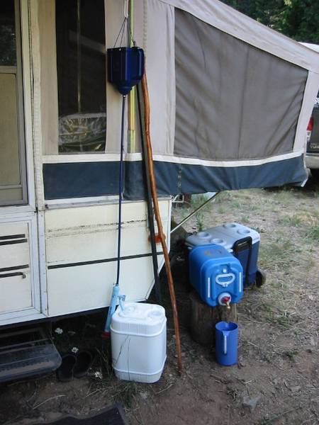

    Here's my current filtration setup, hanging off the side of my popup, but can be hung anywhere high enough. I fill the square, blue 5-gal jug from whatever water source is available. Transfer it via the blue pitcher into the filter bucket, gravity-feeds through the filter into the white 5-gal jug. I can run stuff out of any nastyass cowflop-filled mudhole and end up with clean drinking water. Runs approx 2.5 gal/hour so takes 2 hours for a full blue/white transfer-

    Bob, this looks good. I recall you stating that this is the "Life straw" filter. Is yours the family version? How do you like it?

    Yep, this is the Lifestraw Family 1.0. I've used it on two trips now and it's been great! First trip was 10 days providing drinking, cleaning and shower water for two people. Even though the water source was pretty good, I still filter the shower to prevent algae growth in the tank. Second trip was just me and my dog for 7 days earlier this month and it worked perfectly then as well.
    It may seem like a hassle to have to keep filling the filter basket, but it's not that bad. It holds 1/2 gal at a time and I run it mainly in the evening when we're just hanging around camp anyway. The filter has a back-flush system built in which you work once a day which takes all of about 30 seconds to do.

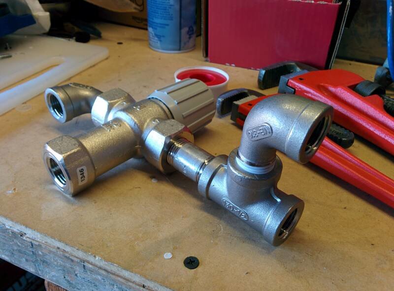

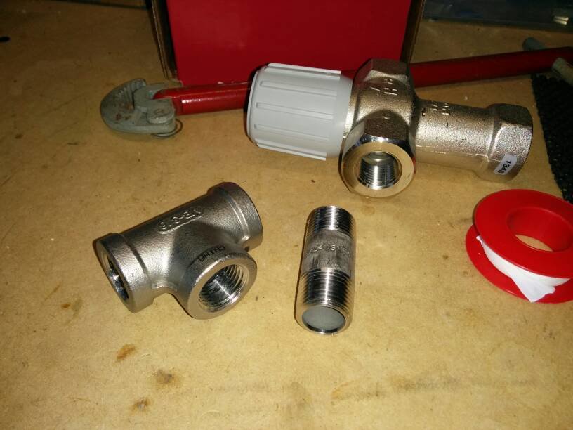

    Some new parts showed up. I'm sampling some cast stainless 316 fittings I found. Looks and feels great. More set to arrive later today.

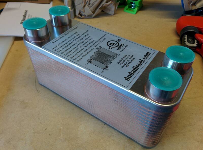

    30 plate. Surprised at how compact the thing is. I did Spencer's old skool flow meter test, and blew hard as I could, and hardly any resistance detected. Lol
    Project should be completed in two weeks.

    Link to the one you got?
