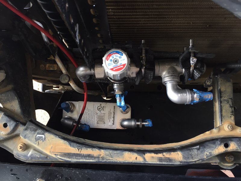

    I used the following for the water side of the exchange:
    https://www.westmarine.com/buy/shie...reinforced-clear-pvc-tubing--P011_333_001_014
    I saw it either on this site or expedition portal as being used by someone else.
    I used this product for the coolant side of the exchange:
    https://www.grainger.com/product/FL...9bc574a32146cc100e534799a7b7585b5&origin=prod
    It was pricey, but I didn't want to go cheap on this considering the impact if something goes wrong. It's working fine so far.

  14. Jan 25, 2017 at 12:59 PM
    #334
    Mcdees84
    Mcdees84 Well-Known Member
    Jun 13, 2014
    #131922
    1,003
    Tallahassee, FL
    2014 MGM DCSB-TRD O/R
    Thanks. I'm wondering if I can just find regular automotive hoses for the coolant to save a little, cause that is some pricey hose.
    Did you put the exchanger up by the radiator? I'm wondering if I can get it closer to the heater core so I don't need as much hose (like mounting it near or on the firewall).
    Any other input from others is appreciated. I've already purchased the thermo mixing valve, water tank I want to use, and have the pump and plate exchanger picked out, just have to order. Hoping to get this wrapped up in the next month or two.
  15. Jan 25, 2017 at 1:17 PM
    #335
    dbrfan
    dbrfan Well-Known Member
    Oct 15, 2015
    #166754
    97
    2015 DCSB 4x4 6SPD
    Yes, I put both the HE and the mixing valve in front of the radiator. In my list of mod priorities, adding a winch won't be happening soon. I have a plate bumper, so I used some of the winch area to mount the HE. I'd like to have it in the engine bay, but haven't figured out what I would move to make that happen yet.
