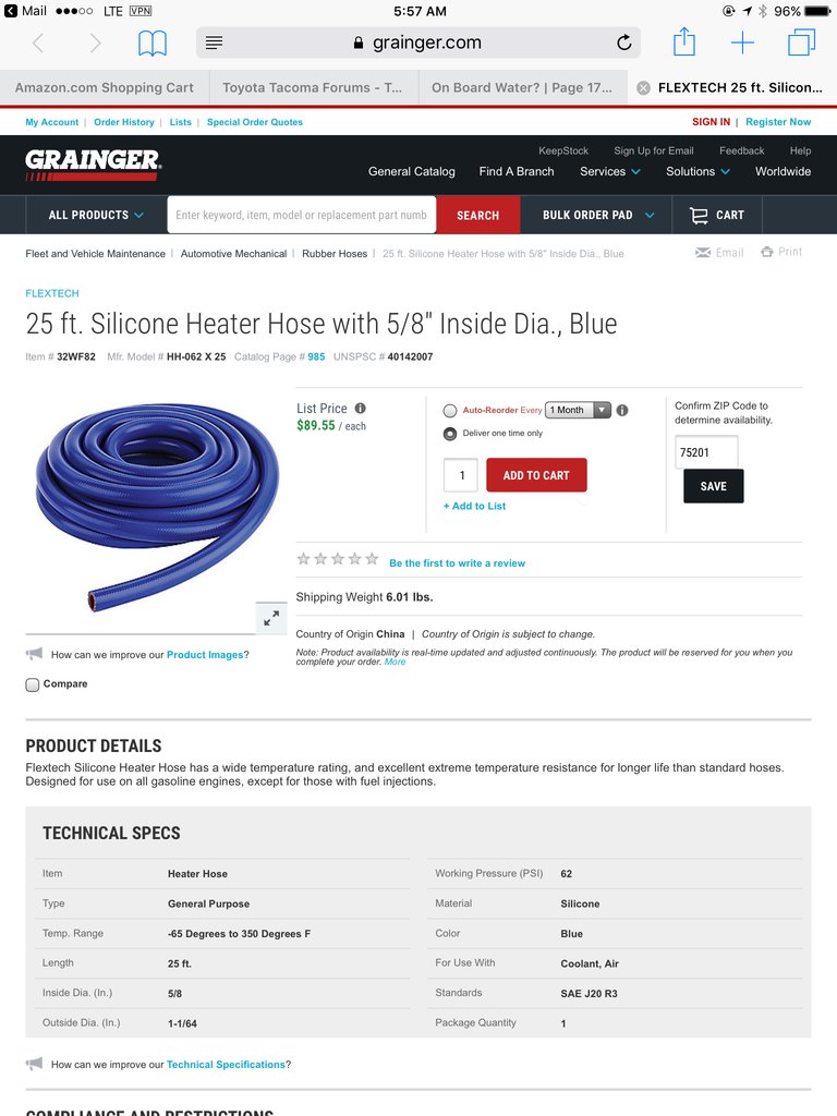

    Here's what I used and it's 5/8" id.
