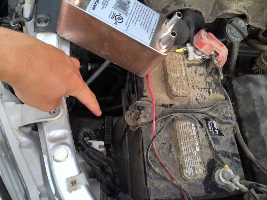

    Where would you install the plate heat exchanger? I would prefer it to be as close to heater core hoses as possible but there is not that much space where the hoses come out of the firewall.
    Also which hose is coming out of the heater core. Is it the top or the bottom? I haven't tried to hard to see where the hoses come from to narrow it down and I figured it would be easier to just ask.

    here is where "Tweek" mounted
    yjyvynet_4d0534fd087466dd452e96c03cc1453a4377b7fc.jpgu9ezagaq_1c4d915ca2b067452826c92988e6846452dbbae2.jpg

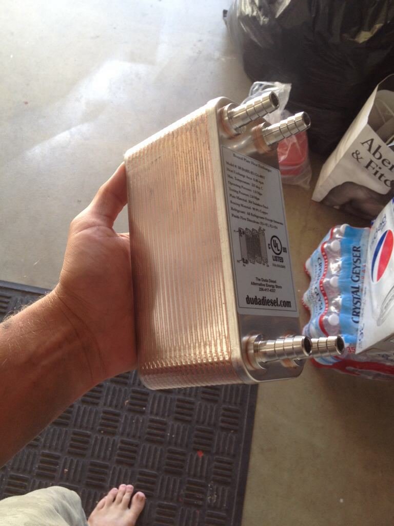

    Found the mixing valve and a 40 plate heat exchange on Amazon! not too expensive either.
    found the heat exchange with 1/2" barbed fittings..... someone mentioned the truck heater core was 5/8" - if i use the 1/2 barbed with two good hose clamps, it should be fine.... right?
