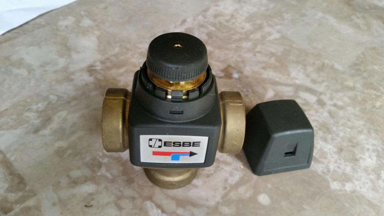

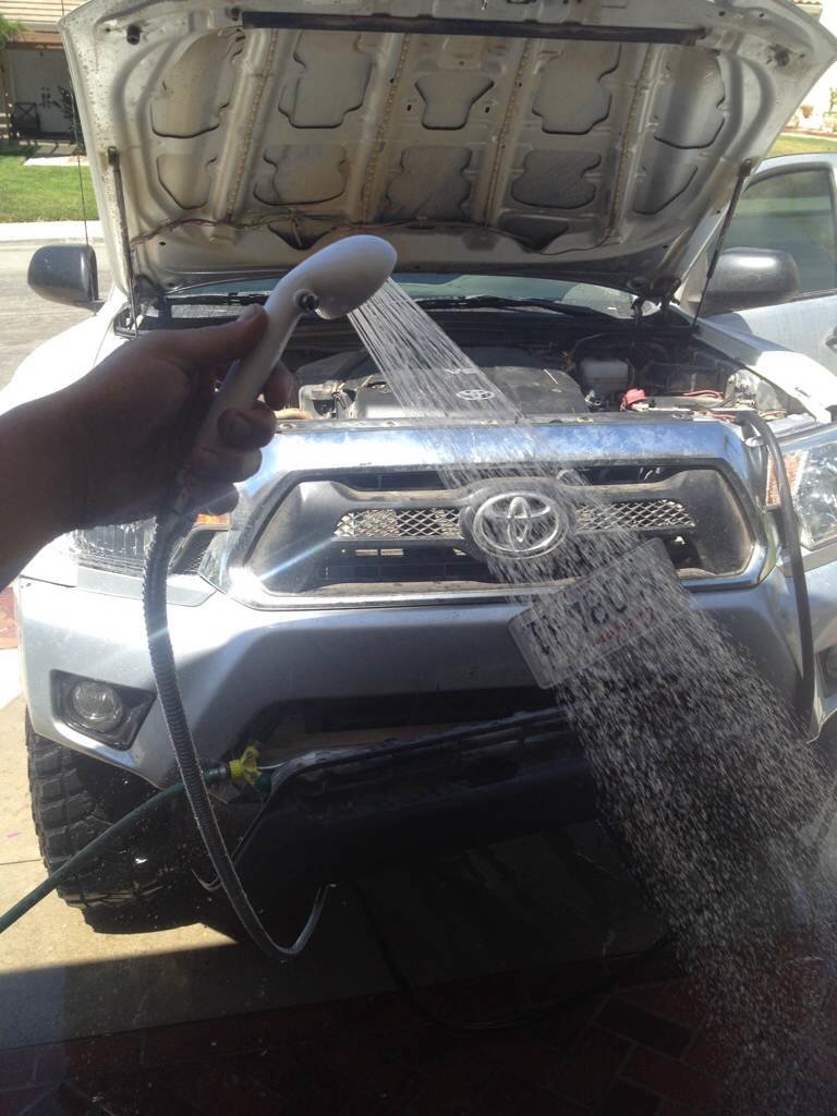

    I deleted the check valve in place of a regular ball valve and it now works PERFECTLY!
    I hooked up just the hot side with a hose & the water came through so hot that the thermostatic valve shut itself off.
    Tee'd in to flow hot and cold from test hose and PERFECT water temp came out of the shower head.
    I'm so damn excited. Now just to mount the pump / hoses & clean up install

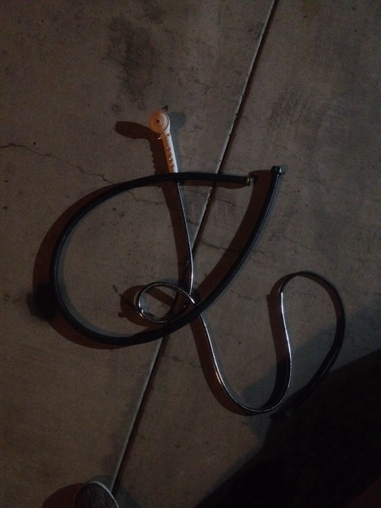

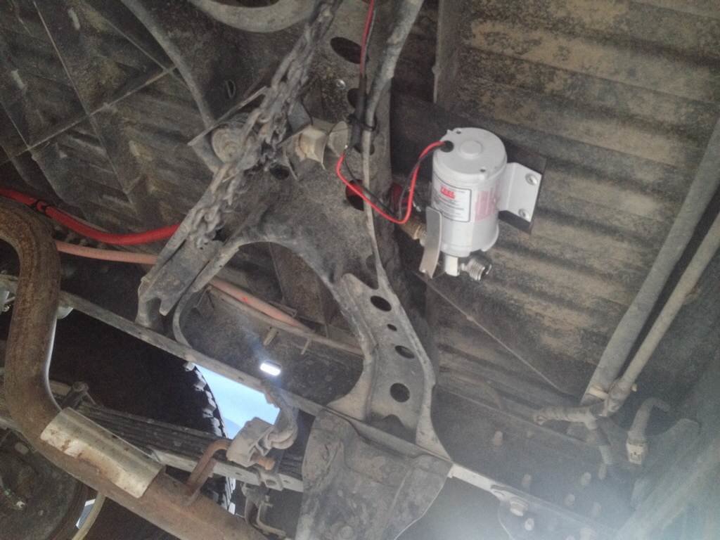

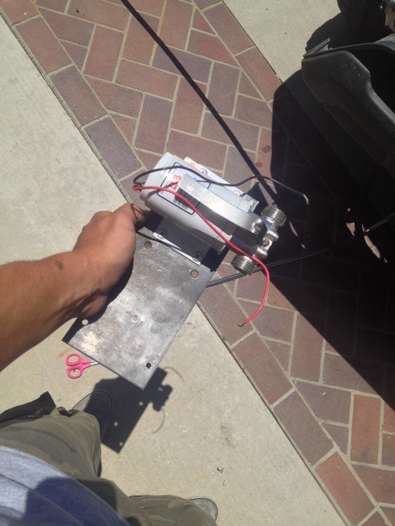

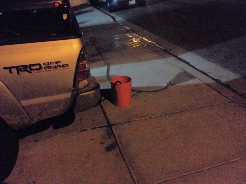

    dyga8u9y_97ec8e66b8845c85e3bed94b3828a410eae36bc1.jpgpump bracket
    Mounted and plumbed
    These two items are all I need to carry now!
    RV shower head and a length of double female garden hose fittings- they stow easily in the cab and are just as easily replaced at a walmart if lost or broken.
    The shower head screws onto the mixing valve up front and the double male goes into the pump
    Throw it in a 5 gallon bucket & good to go!
    Five gallons lasts just under 10 minutes- no pressure or temp drop. Kept the engine around 180 degrees as well.
    :bananadance:
    Im proud of this one.

    Solder those connections and put some type of wire looming over it too.
    On the pump. You have both ends sealed? Meaning capped off or plumbed? Don't want foreign objects entering the system.
    ^that's where the other fittings and stuff come in mentioned in this thread

    I went the lazy route this time & used my shrink wrap butt connectors with a big length of shrink wrap over those two so I'm not worried about water too much.
    And the wire is 10 AWG & zip tied off to spots that will keep it from rubbing- not worried about that too much either.
    As far as a cap, I do need one to keep dust out of the inlet port on that pump and I need to figure some kind of filtration (I'm thinking an inline fuel pump) because right now it's only safe to run clean hose water through or drinking water.
    An oversized fuel pump should work fine IMO- I think I will put it inline to my female / female connection I carry
