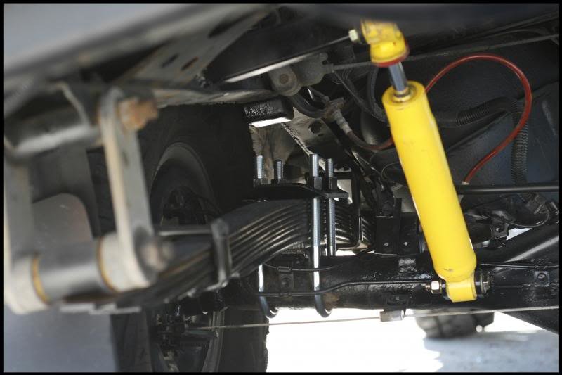

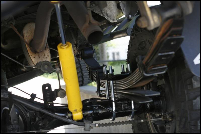

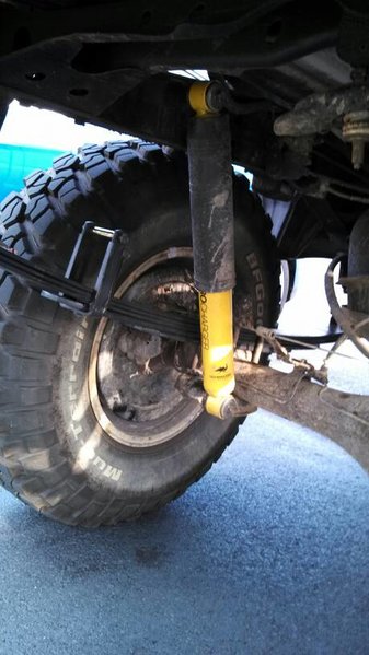

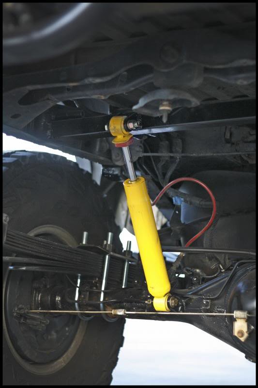

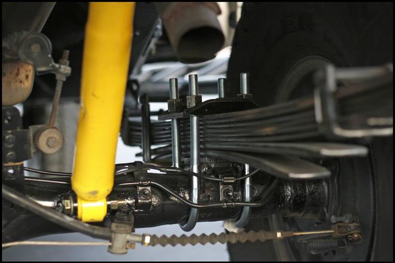

    I'm a newbie, I've gotten info through searches for years but have rarely posted. I just wanted to share a success story on 1st gen rear leaf spring issues. After sitting on blown out negative arch stock leafs for years (I've had my truck since 98, 190K miles, well maintained but used hard, wheeling, towing, and as a dd) I got a set of "heavy load" OME Dakars and OME nitrocharger shocks. The leafs failed in 4 days, on the first wheeling trip. Negative arch, dented the shit out of my shocks, sat lower than stock. Got replacements on warranty, they lasted about 8 months, then the same thing happened. Got another set on warranty but with tha AAL. Put those on with a set of 4.5 inch Energy Suspension polyurethane bumpstops bolted through the bumpstop contact point on the frame, instead of on top of the leaf pack. Works like a charm. I get more oversteer at high speeds in low traction situations, but that just makes it more fun. Yes my up-travel is slightly reduced, but after dealing with total leaf failure and coming home from a wheel and seeing my rear negative arched, sitting 3" lower than the front, I'll take it. I really don't notice a lack of articulation at all. The energy bumpstops are soft enough that I can barely feel it when they hit the leafs. Sorry if I'm posting this in the wrong place, but I couldn't find any 1st gen leaf spring threads newer than 2011.

    post up some pics!
